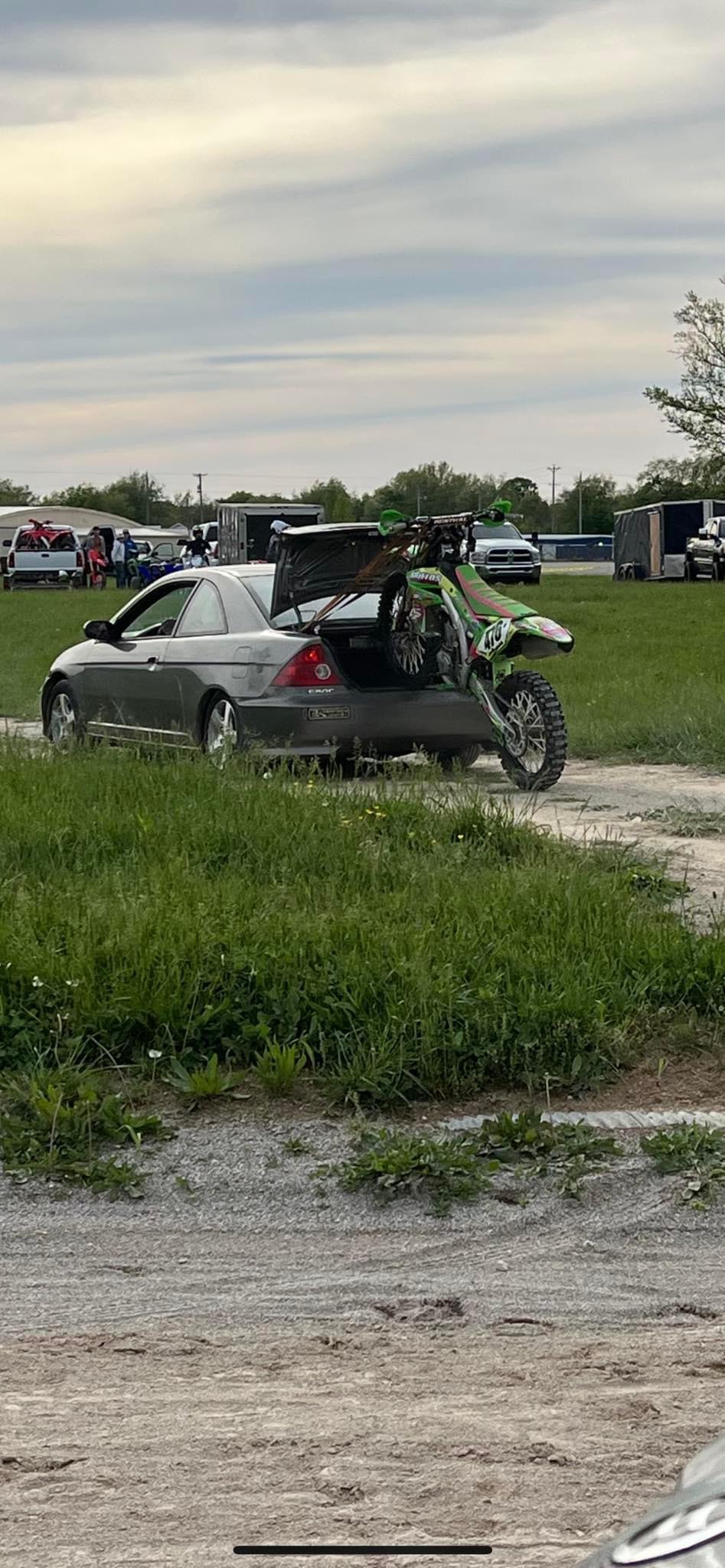

How much damage would this cause?
429 Sterling
312
11/19/2023
Boston, MA, USA
Not my photo, found it on Facebook. I assume that would put an enormous amount of wear on your transmission, wheel bearings, and countershaft bearing. Especially if taken on the highway.

Take the chain off

Should've at least pulled the chain. Would look legit with a tail lamp Smile

David Bailey did the nationals like this one year. He used a wheel with a street tire on it.

My buddy has a Taurus with a trailer he hauls with, much better than the drag method

His rear tyre suggests that this is a common occurrence... 😂
I've gotta give it to the guy though, if he wants to ride and that's his only option, he's making it happen 👍

Street bike bearings last tens of thousands of miles, keep them greased and they'll be fine.

Exactly. Very little load on all the components in this situation. No rider weight and everything is just freewheeling. Other than rear tire and chain slider wear I don’t see a problem.

I kid you not, I had a friend who wanted to get into riding....but he owned a 78 Nova.   That didn't stop him.     He "trailered" his bike around just like that.
He only did it locally though, not on any  highways or the like.

Are the tie-downs on the trunk hinges? That might actually be the craziest part of this picture.

The bushings on the freewheeling gears in the trans...ouch

Take the chain off.
put your bike on a stand and spin the back wheel. Feel that drag?   What do you think that might be?

 He could have at least taken the chain off, then he would have only been ruining his rear tire.
