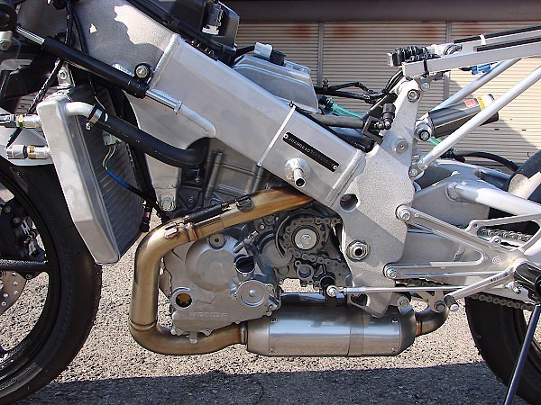

Hondas Moto3 engine of the NSF250R and RW (and whatever designations they've gone through in the last near decade of Moto3) , is a reversed, tilted back cylinder and head design, in use since that class started.
Said to be developed in 2011, whereas the YZF450 came out in 2010, but you can be your arse that Honda had that reverse cylinder in 'development' well before 2011, with their machinations for 'all 4t stroke, all the time ' racing classes. Yams 250F Reverse cyl /head, came out in 2014, I think.
I'd say Honda were very pissed that Yamaha brought out their version before they themselves put it into use in a vastly larger sales market that the 250 and 450 Offroad and MX market is over the Moto3 side of things.
Honda would, I think, never want to be seen as following another manufacturers engine 'idea', especially Yamaha. I really do think it was a design they wanted to be 'theirs'. They got thoroughly gazzumped by Yamaha, who've adopted it as their USP on the YZFs and WRs . Cool
Of course, there's been myriad reverse cylinder and head engines in bikes, both 2t and 4t for decades. TMs Moto3 engine (I think only used so far in Italian domestic Moto3?) is a reversed engine, but heck, I think most of their Kart Engines are 'reversos'. Well, many Kart engines from other manufacturers are 'reversos'.
