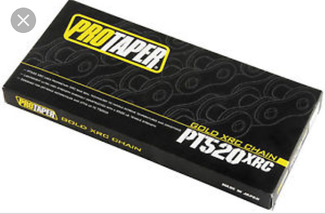

swtwtwtw
1287
4/16/2008
Apple Valley, CA, USA
5/14/2018 4:24pm
ProTaper has released a thin oring chain.
