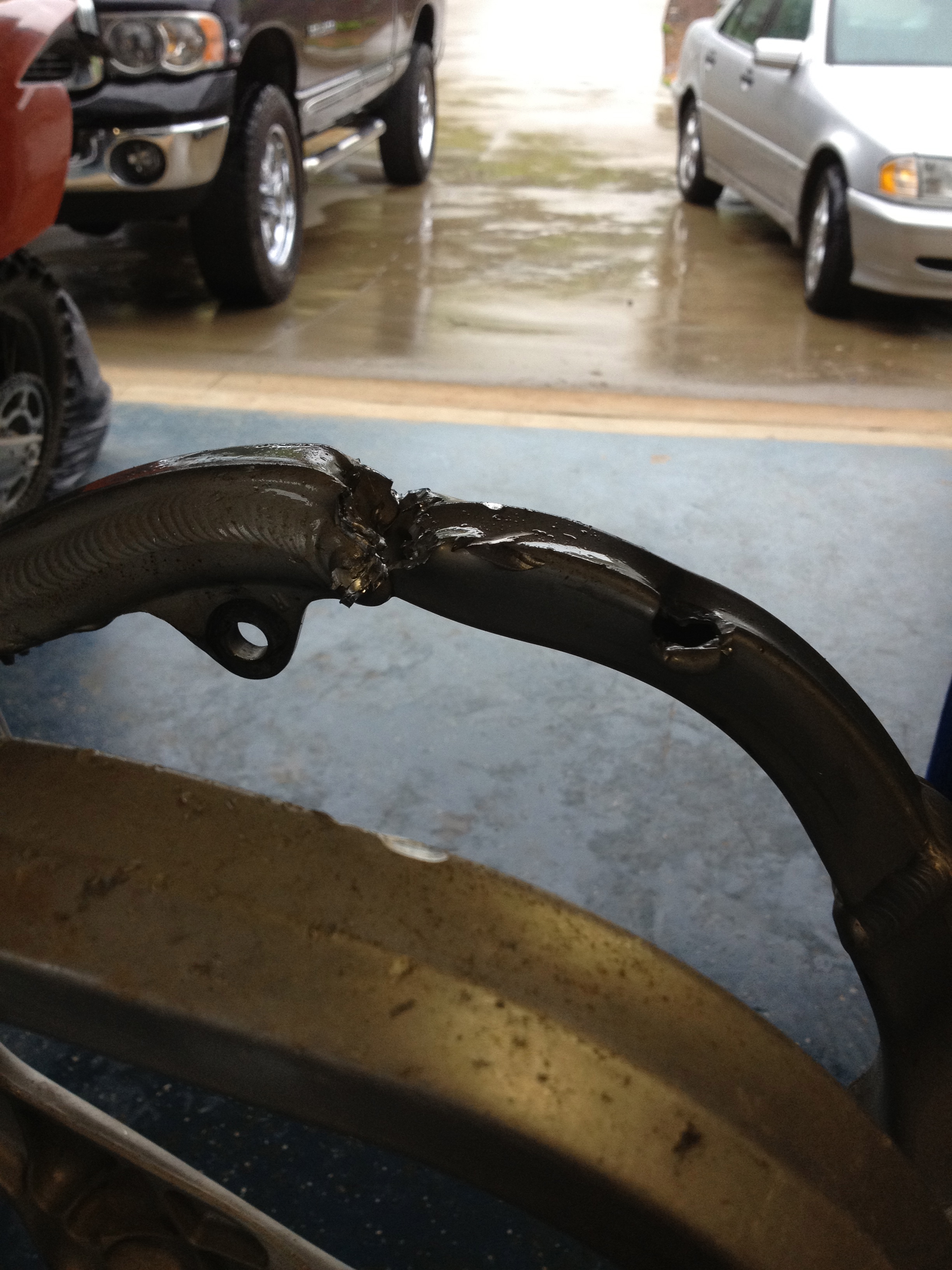

2012 CRF250R frame, landed on a downed bike. Local dealer $1000 +tax for a new frame. If it was yours would you have the frame repaired or fork out for a new one? It might not have completely prevented it but I think I will buy a skid plate.

See about sending it off to Service Honda. They could repair that and drop a CR500 engine while their at it.......Seriosly, Service Honda might be a good place to call and get their two cents worth since they cut and reweld those frames for the CR500AF bikes.
Myself, I would look for a part out bike and grab the frame for cheaper than a new one but only if I could inspect it first.

FWIW Service Honda lists it for 840$. plus shipping of course. Thats for a 2011 frame.......should be the same.
http://www.servicehondapsn.com/fiche_section_detail.asp?section=1414279…
It could be fixed, but it would have to be by someone with lots of aluminum experience would understands how to heat treat it.

What the rest of the bike like? If the rest of the bike is OK I would replace the frame, 1000 bucks is cheaper than a new bike. If the rest of the bike is crap then fix it and sell it, or part it out. I agree100% with tobz, I could not ride that bike with a repaired frame like that.

wow thats crazy. id find a near by welding shop. i know its important to get it done right, but its also not rocket science. theres gotta be someone near by that deals with aluminum welding, custom fab.
that didnt mess up the motor?

fix it....find a professional welding shop that specializes in aluminum.

Urgh, righto bud, it goes along the same lines of, if I had a bike that grenaded itself, id fix it, and sell it, being slightly ocd. Similar to the guy around here that crashed his brains out after his TM throttle stuck wide open, probably nothing wrong with it, but he sold it off.
There'd be nothing wrong with welding that up properly.

replace asap.... you will not be able to regain its structural integrity

Look.....I see both sides of the argument between Tobz and the rest of you guys. I think what Tobz is saying is....his confidence in the bike would be shot knowing that the frame had been damaged....I know it would bug the shit out of me too. I would definitely tell the new owner what happened though.
MxSkillZ : The frames can be repaired to "Stronger than normal". These frames are built tough....but are also built extremely light! If a descent welder ( Like what was mentioned above about Service Honda )....they not only could fix that frame but probably gusset the shit out of it and make it " Stronger than before".
It's like snapping a twig.....then bolting two 2X4's next to it.......ya think it may be stronger now? Same can happen with aluminum if it's in the right hands.
I wouldn't have any local welding shop do this. I would send it to someone who knows how to weld these frames and does it for a living. They know where the stress points are and what would need to be done....to do it correctly.
5/13/2012 8:22pm
Jesus, stop bitchin ,Im a welder, like stated above its not rocket science,get the damn thing welded end of story unless you have money to waste on a new frame.

Looking at the first picture, the one that shows the full extent of the damage, it appears you'll have to "section" that. At least that's what my welder guy would tell me!
Second concern would be if stock frames are heat treated or not? Typically from past experiences the weld holds but it'll crack right at the edge of either side of the welds. That just what has happened to various aluminum parts I have had him weld up over the years.
Also, be careful who you get to do the work, many will talk the big talk about how awesome they are but I've seen some really bad hacks over the years!!!
I would say only try and fix it if 1)You are slow and don't "punish" the bike(blitzing whoops, flat landing etc etc), beginner rider speed almost. And 2)You don't have the fundage for a new frame.
Even then, try it out slowly and keep an eye on it. It won't just SNAP and drop your motor off. Again, if done correctly.
ME, I could never ride on that!
Good luck either way.

Im sure an experienced welder could repair that just fine. I'd keep and eye on it afterwards, obviously, but I doubt it would completely fail all at once, it would show signs of failure before it came apart. The engine cradle doesnt have the amount of stress on it as other parts of the frame to be pulled apart so I'd try repairing it before forking out a grand for a new one. Just my 2

No, only because you don't know where else that frame is tweaked or weakened. It would take a full metal/structure analysis to figure that out and who woud you get to do it?
