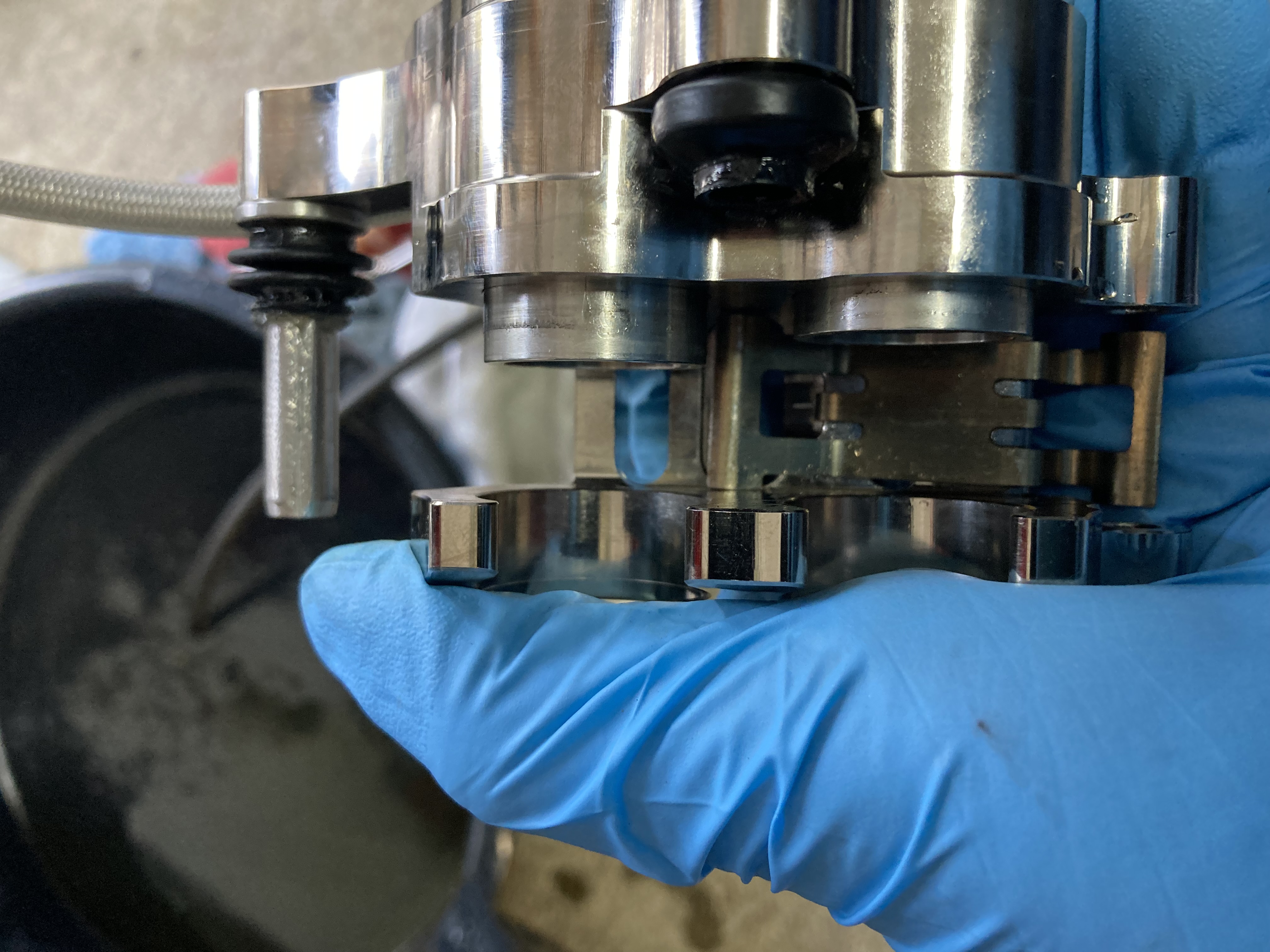

UPDATE-
Nothing worked. Took everything apart, pistons out of caliper, ect. One of the pistons is much tighter than the other in the caliper. I measured them but they are both the same size 23.98mm-ish. Called Technical Touch as they are USA importer for MotoMaster. Tech wants me to reassemble and run in the caliper a bit.
Put everything back together and did the following-
Gravity bleed
Pump lever a few times
Draw a decent amount of fluid through system with vac bleeder.
Pumped lever and got so far the best lever to date. I've been flicking and teasing the lever and turning bars lock to lock and its not getting any better but not getting any worse.
Not sure if a sticky caliper seal is at fault or what.
Got it held down and I'll check it again in the AM.

I'm starting to suspect that sticky caliper piston you mentioned.

I think so too.
After reassembly, it seems better. Has maintained lever and has not gotten any worse, best it’s felt yet. I keep using aees bleed method and holding down the lever.
Out of town for a few days so I’ll leave it strapped down while I’m gone. It’s light years better than it was so I actually might try riding it and getting some stuff moving and heat cycled.

Just to update this, I really do not believe it’s air at this point.
Ive held the lever down over night, durning transport, I’ve left it alone, it feels the same, no change. It’s hard to explain, but it feels like there is just too much lever travel resulting in a “soft” feeling. I really believe at this point it is the sticky seal on the caliper, but after a couple rides in it does not seem to be improving.
I might order a set of seals and replace them but for now I’m riding it hoping for improvement. This caliper came with the bike, and though I “paid” for it, I’d be pretty disappointed if I dropped the coin on it myself looking for an upgrade.

If you pull the lever, is there at least some movement of the pistons? That would be consistent with air still trapped. If not it may be problem with the master cilinder. Tbh it should've been fixed after all that though. Reverse bleed with a syringe is really the best way to do it, if you put a little teflon on the threads of the bleeder screw that helps to have a better seal when flushing. Pushing the air up and out is better than trying to collect them at the bottom. Be sure to fully press in the pistons repeatedly and pump them out again cause it's an easy spot for air to be trapped. Remove the caliper and try to get the line in an angle without any bends
