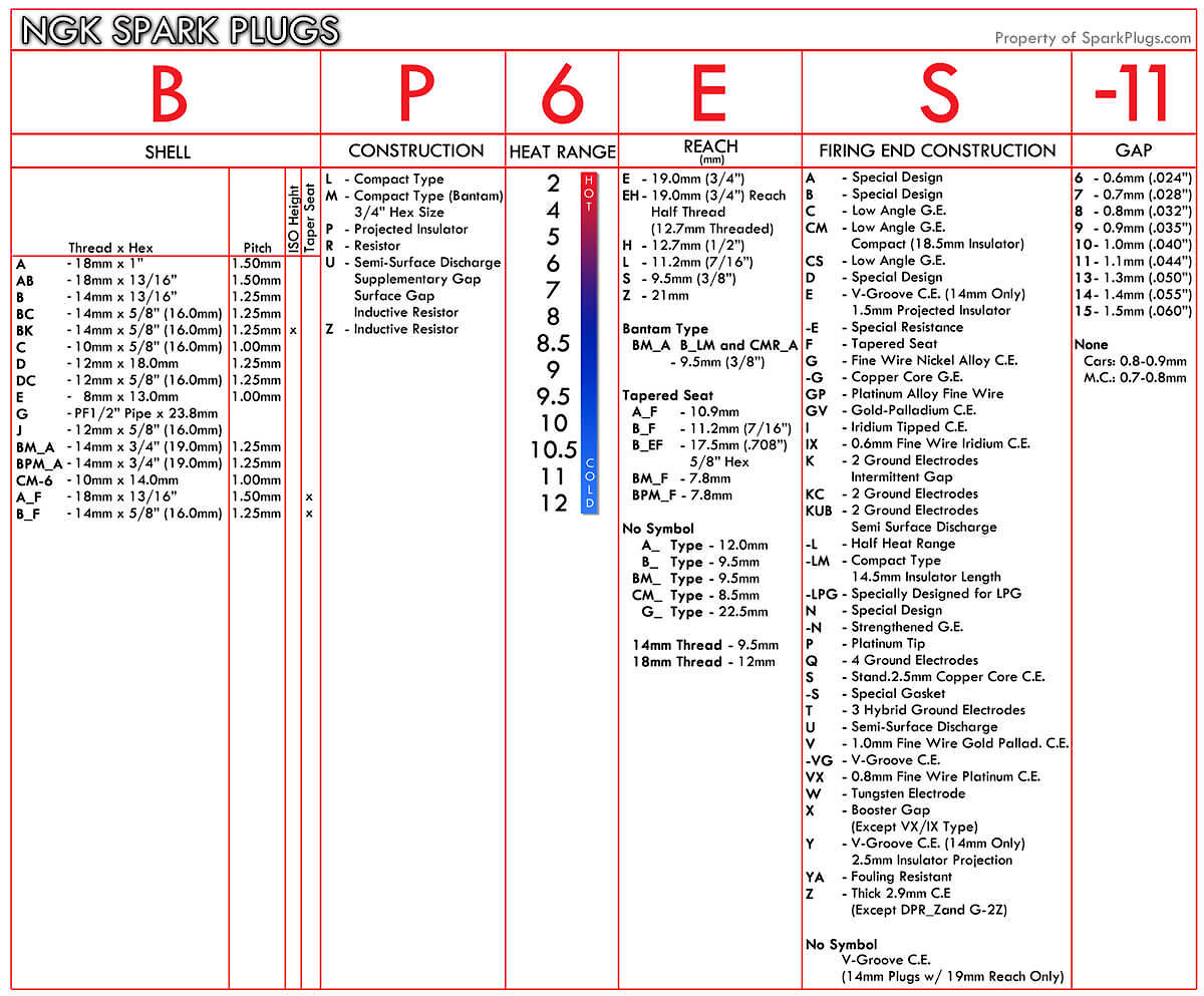

I usually run the stock plug for my KTM 125 which is on the right in the photos (BR9ECMVX). On the left is the recommended replacement from NGK (BR8ECM). I know it’s a different heat range but the electrodes look slightly different and the KTM plug has three blue lines compared to the Non KTM plug having one.
Anyone educated enough to tell me the differences between the two and if the different electrodes actually make a difference?

The BR9ECMVX looks a lot like a BR9ECMIX, which has an iridium electrode. Iridium is less prone to fowling and lasts nearly forever. Not real sure why the PN ends in VX instead of an IX though.
Edit: Maverick with the facts below. The VX is platinum. The replacement you bought has the standard center electrode.
12/8/2020 12:55pm
The right side is a wire type electrode and they're designed for 2 strokes because they are less likely to foul or do so more slowly. Because of the smaller, more delicate electrode the wire types are usually made with iridium or some other type of exotic material. In the case of the BR9ECMVX the core is made of platinum.
The BR9ECMIX should be the aftermarket replacement replacement to the BR9ECMVX.
The VX is branded as a stock spark plug from KTM, but the IX iridium version is available through NGK. KTM Group stock spark plugs are the only versions of the VX available whereas they've been superseded by the IX via NGK.
12/8/2020 12:58pm
The right side is a wire type electrode and they're designed for 2 strokes because they are less likely to foul or do so more slowly...
The IX is the same as the VX then, correct? The VX is just KTM's way of branding the plug?

The BR9ECMVX looks a lot like a BR9ECMIX, which has an iridium electrode. Iridium is less prone to fowling and lasts nearly forever. Not real sure...
TheGetFresh had some good information as well. I didn't buy the ECM yet, but am just going to order the BR9EIX from Parts Unlimited.

Run the ECM, not going to hurt a thing. If your jetting is close, you will not foul a plug anyway. Why spend double the $ for no benefit?
So far as the product code goes, the IX is iridium and the VX is platinum. Otherwise they’re the same.

Run the ECM, not going to hurt a thing. If your jetting is close, you will not foul a plug anyway. Why spend double the $...
Double the price, but the iridium plug will last the life of the bike.

I am running the BR9ECMIX, PU part# 2103-0045, in my Husky 125. They run great. That extra C in there gets you the low angle (recessed) ground electrode. I don't know how close the clearance is on these bikes but I don't want to find out the hard way either. The M gets you the stubby compact top side. It looks like there's plenty of clearance under the tank for a full size plug so this might not be a big deal.

Do see the difference in heat range ?

KVA_536 wrote:
Care to elaborate? Just picked up an ‘03
Run the plug specified by Suzuki, it’s 20 + dollars or so but you run the risk of the cheaper options coming apart and dingin around your cylinder.
In short, it was developed to not fail in that application.
