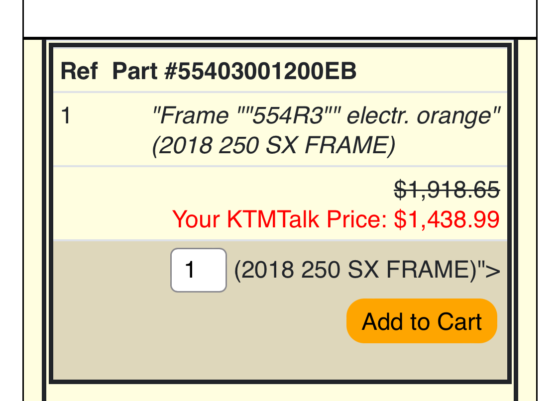

If you spend $60 (I think?) on a KTM Talk membership, Munn racing gives some pretty good discounts:
