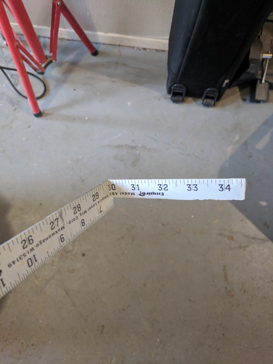

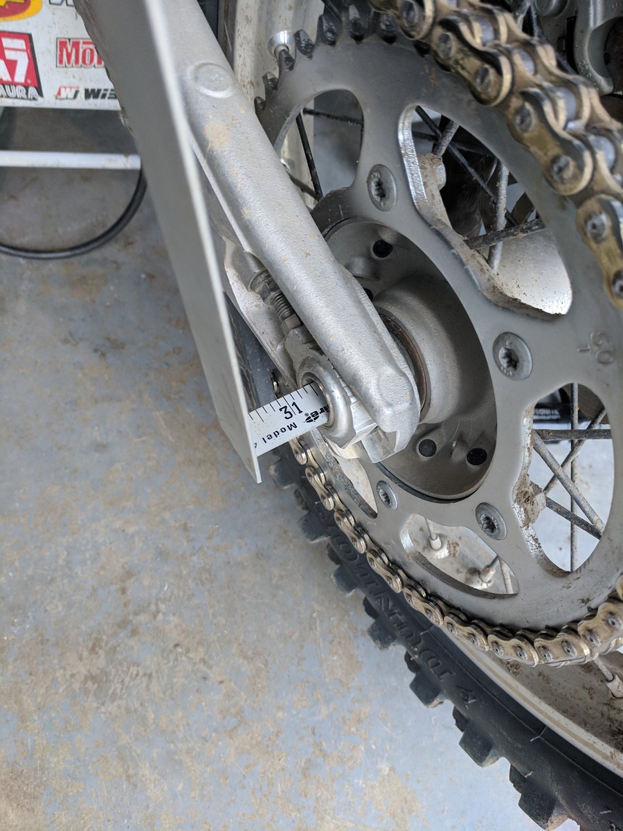

I'm old school so I've set mine up the old fashioned way with a regular tape measure for about 30 yrs..

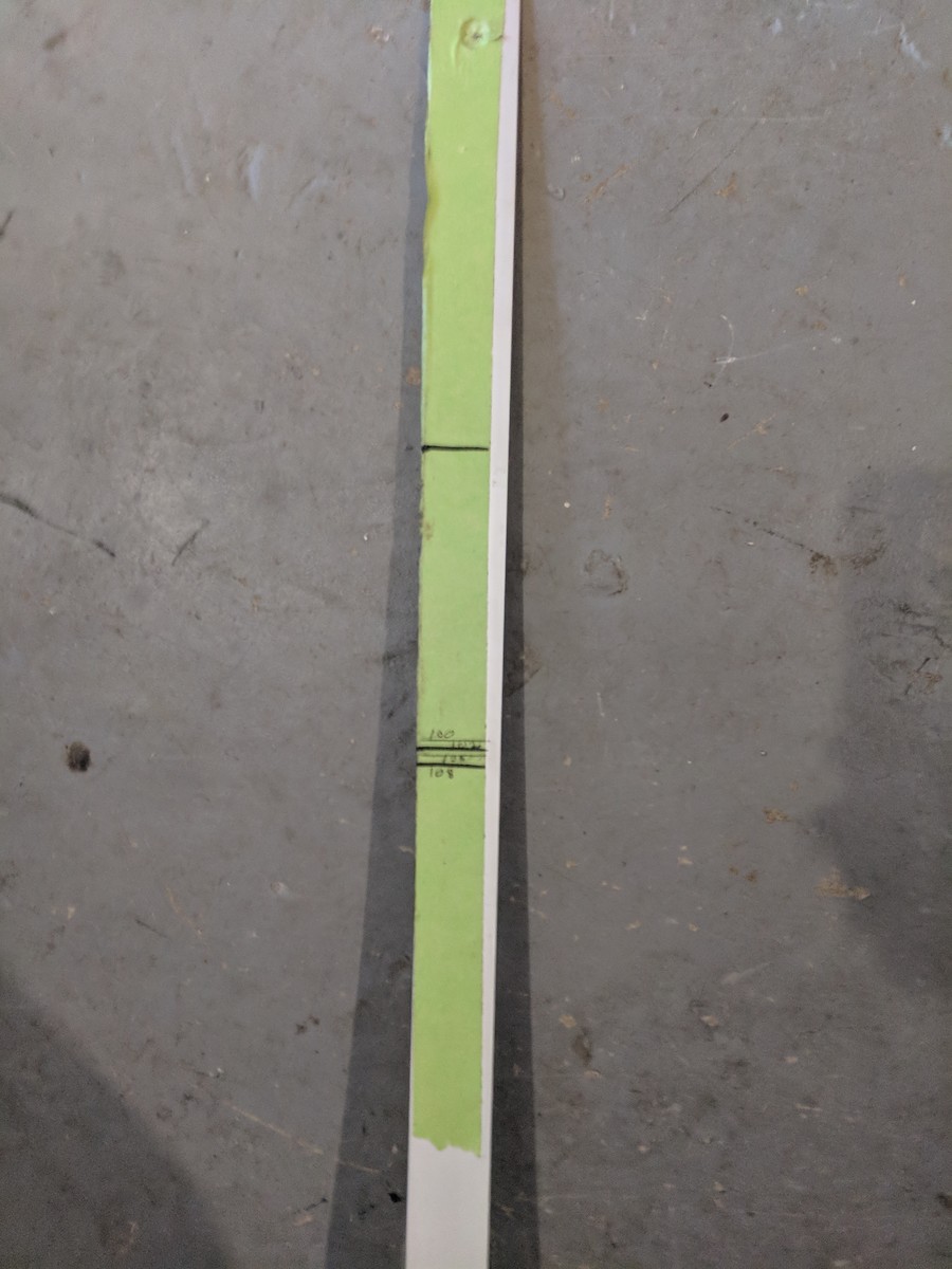

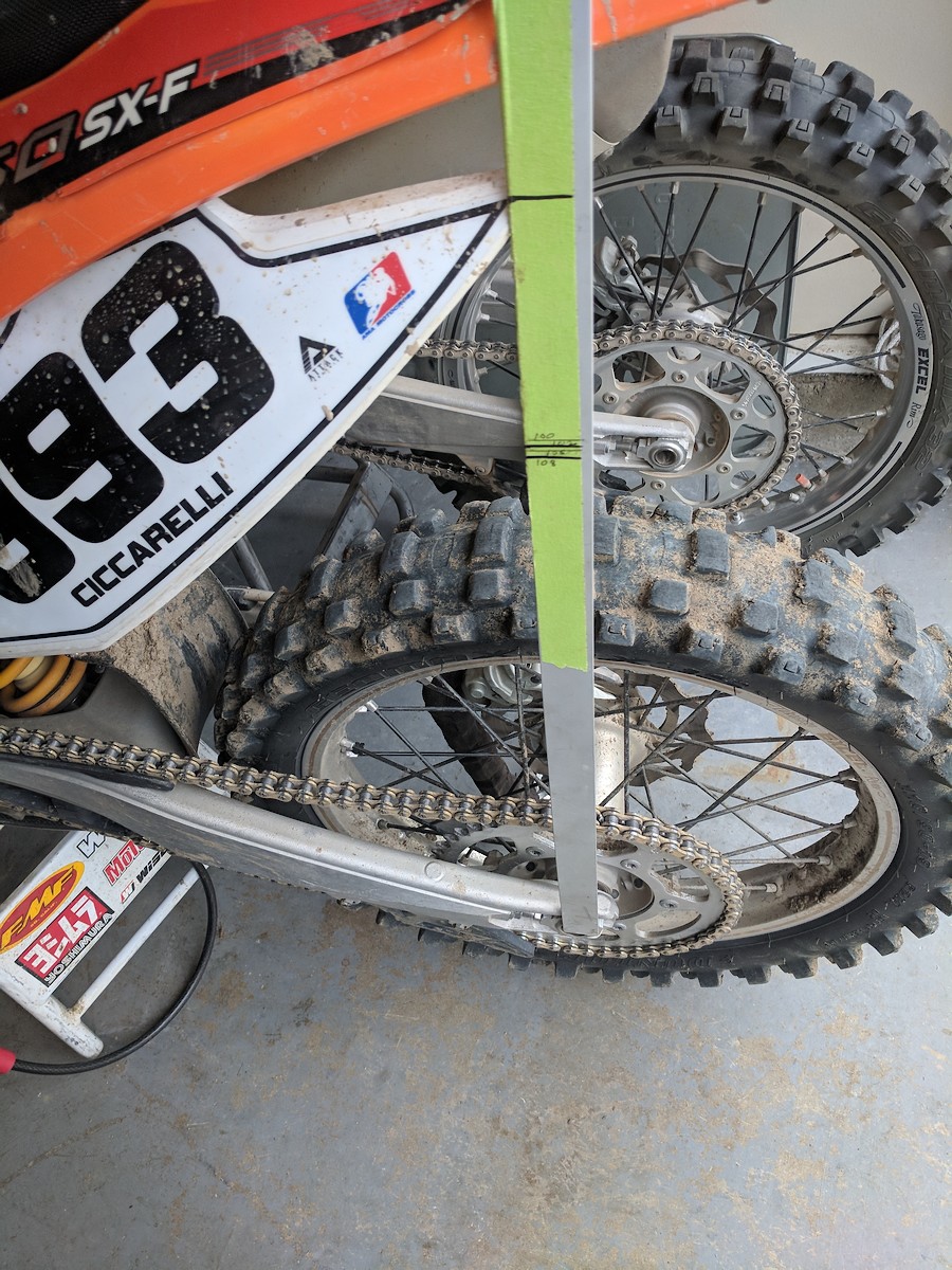

I always found setting sag to be a pain in the ass when you try to do it yourself so I came up with an easy way for me to set it for $5. I bought an aluminum yard stick, notched the end so it would slide into the rear axle, and marked predetermined sag settings. It slides between my rear fender and number plate and I use the line on my number plate as my reference point.
