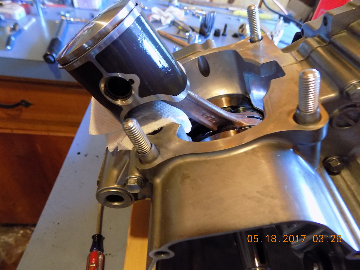

I've had good results with cast Vertex "B" in Honda "A" cylinders on CR125R units... But I change them at roughly 20-25 hours and I am fat and slow. Done this twice. I have used the Vertex "STD" and "Race" 53.93 pistons with equal success. Bore/ring end gap/squish were GTG. They look great when I toss them. Here is a new Vertex "Race" unit, IIRC. A bit different than the all-over grey/gray coated Vertex "STD":
Next up is a Wiseco "Racer Elite" for latest (Re)build. Of course, measuring fitment is key, but Wiseco isn't "garbage" by any means if you measure/fit/adjust accordingly. Cast or forged, warm 'em up good before you roll out hard, always.
Additionally, clean up your shit before you open and work on the guts. I have seen so many "Woe is me" threads wondering why a simple piston replacement on a filthy unit "ruined my engine"
