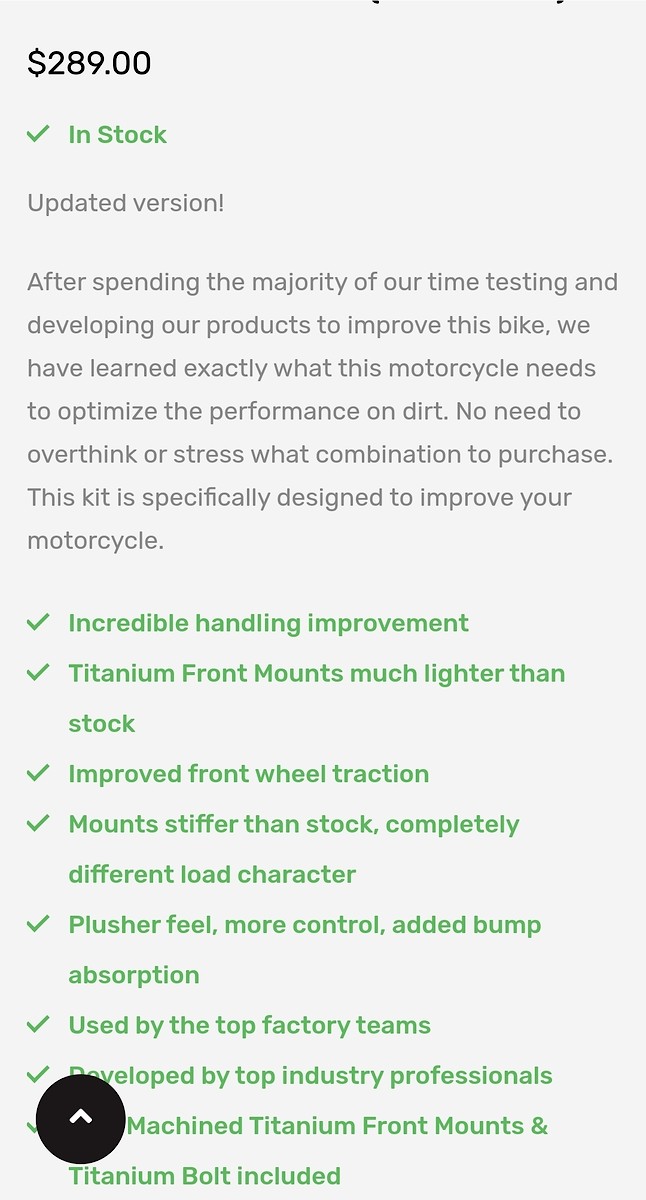

Guys - I'm after some input.
For those of you that have tried the FCP engine mount kits designed to improve handling, how did you like them?
I'm considering these kits for my 2016 YZ250F and 2020 YZ450F, but any and all inputs ARE WELCOME!!!
Here are the kits I am considering:
https://fcpracing.com/product/yamaha-yz450f-fx-2020/ --- $429
https://fcpracing.com/product/yamaha-yz250f-2014-2018/ --- $289
I look forward to hearing about your experiences!

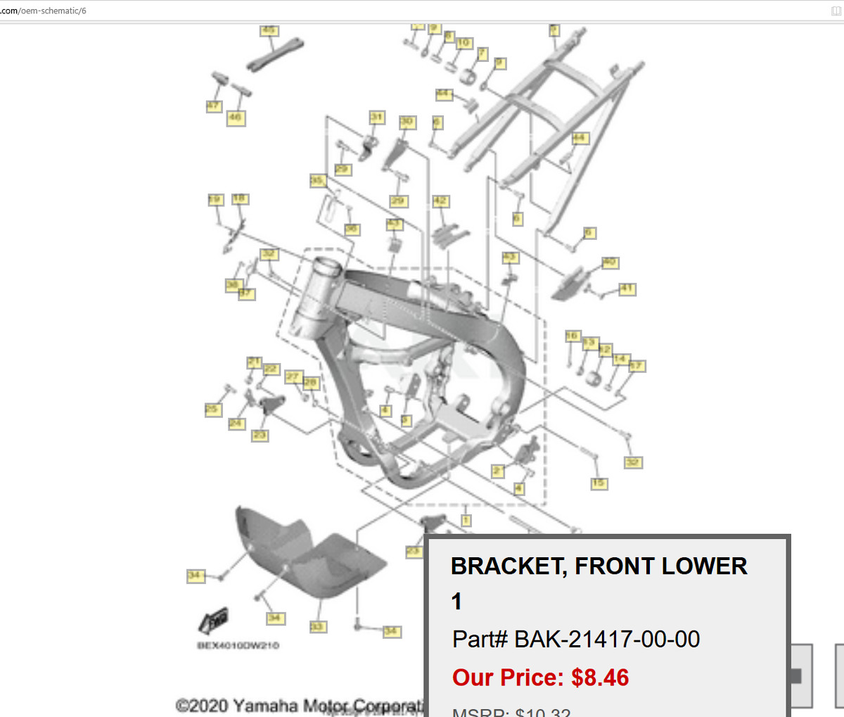

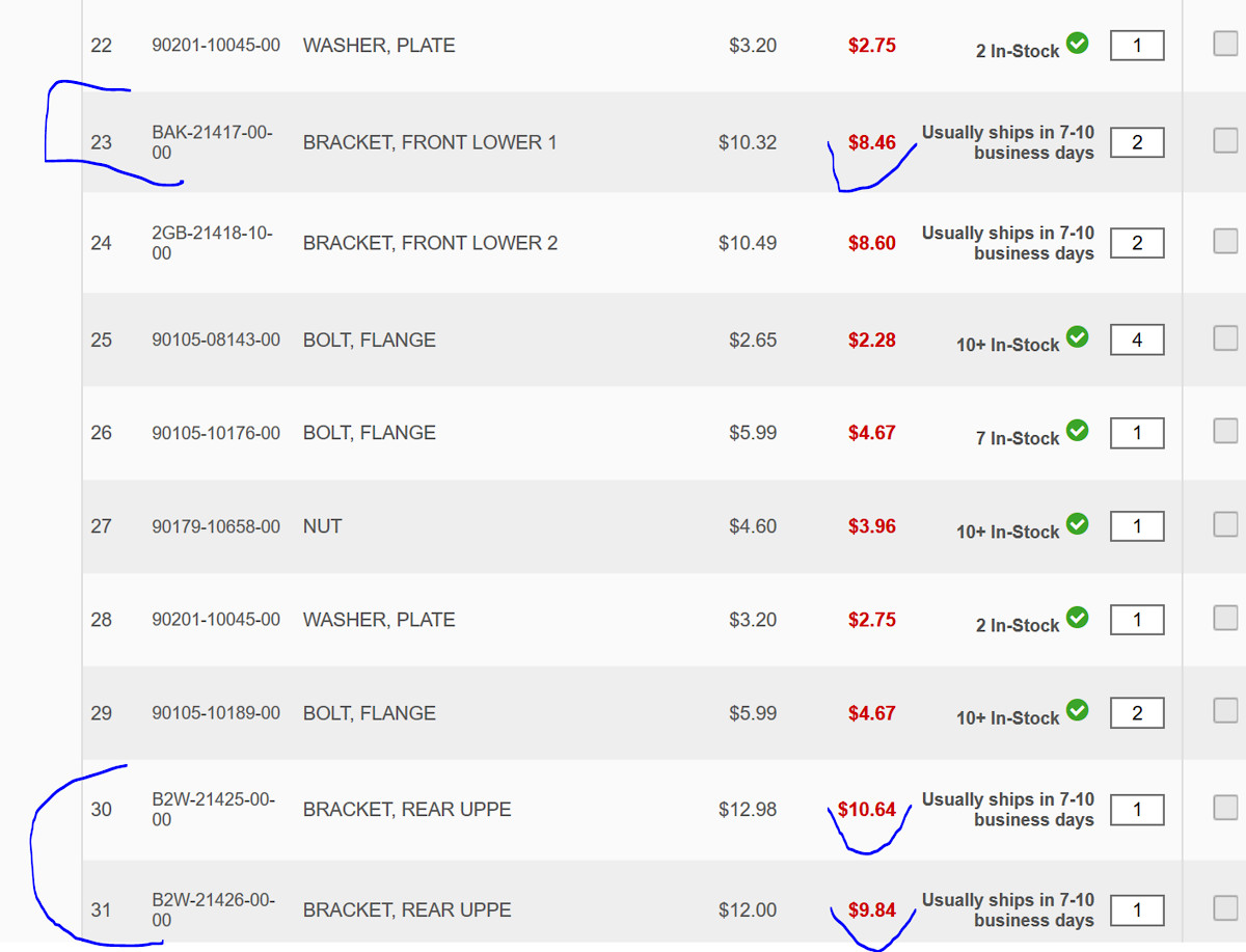

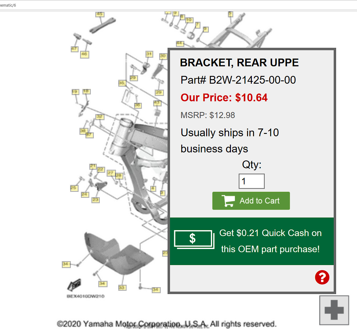

Doing a teeny bit of research per yzf162's excellent suggestion, I'll be trying 2021 YZ450FX mounts on my 2020 YZ450F mx bike to get a feel for what type of handling changes the WCL/FCP specialty kits will bring.
So, it looks like I'm looking at:
(2 8 $8.46) + ($10.64) + ($9.84) = $37.40 to try a complete set of new mounts … ($37.40)/($430) = ~ 9% of FCP kit.
So, a GREAT suggestion - much appreciated, I'll let you guys know what I find out with this experiment.
Lastly, note that I 100000% respect the R&D that goes into development of products like the engine mounts from WCL/FCP, so if I see a positive/large difference with the YZ450FX parts, I'll likely buy WCL or FCP for that extra level of performance and I will again share the delta.
