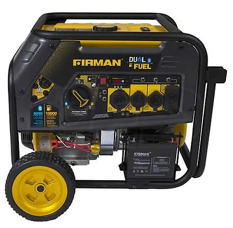

I bought an 8,000 watt Firman at Costco.
Got a 6 circuit Reliant transfer switch and a remote outdoor power box to plug the genny into.
Like this one at Lowe's. (the price seems high, though. you can probably do better)
https://www.lowes.com/pd/Reliance-306LRK-6-Circuit-Transfer-Switch-Kit-…
I had an electrician pull 6 circuits from my breaker box to wire into the transfer switch.
I can run a fridge,a chest-type deep freezer, well pump, sump pumps, furnace, small kitchen appliances, lights in 4 rooms + directv & tv , computers, etc with no problems at all. Probably could have gotten away with a 6500 watt unit, but the well pump and sump pumps draw a lot of power.

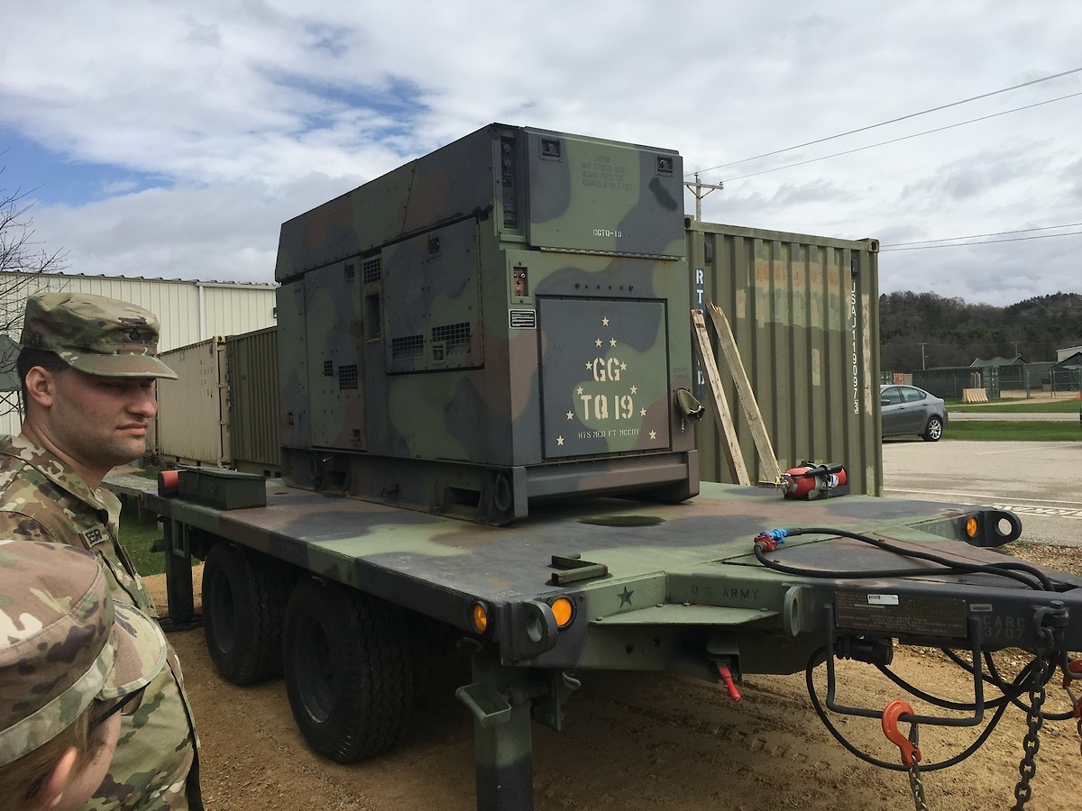

has anyone ever bought a military surplus generator. I have really been thinking of getting one on a trailer https://www.govplanet.com/for-sale/Generator-Sets-Fermont-MEP-802A-5kW-Gen-Set-Kansas/4814146?h=5000%2Cct%7C35%2Cc%7C13%2Cmode%7C2&rr=0.07692&hitprm=&pnLink=yes $800 [img]https://cdn.ironpla.net/i/5460/402/3e72c836-4c01-4fe9-96de-a91a9d027200.jpg[/img]
https://www.govplanet.com/for-sale/Generator-Sets-Fermont-MEP-802A-5kW-…
$800

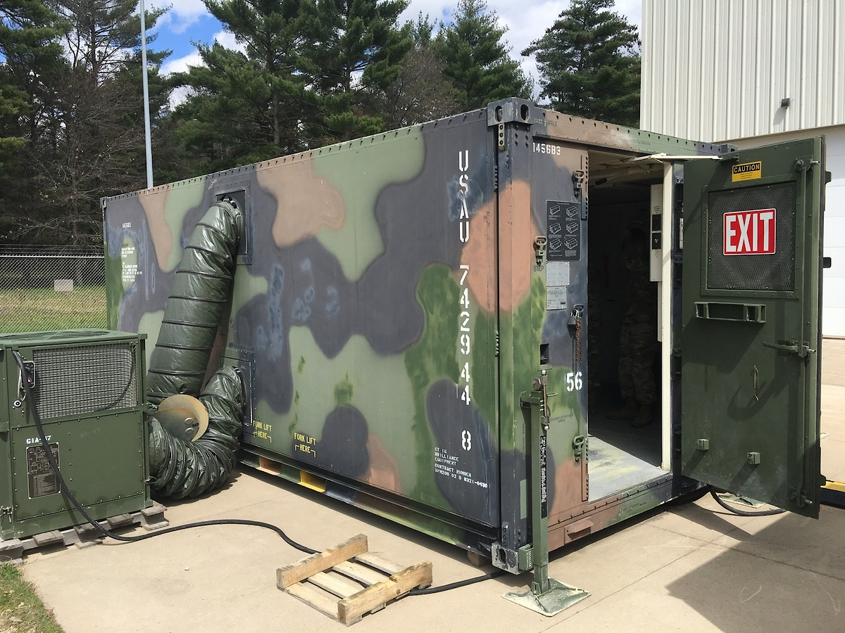

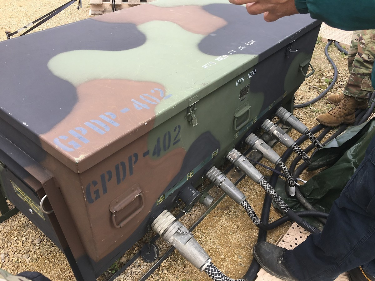

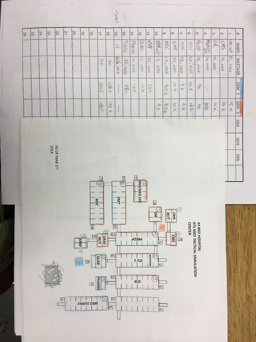

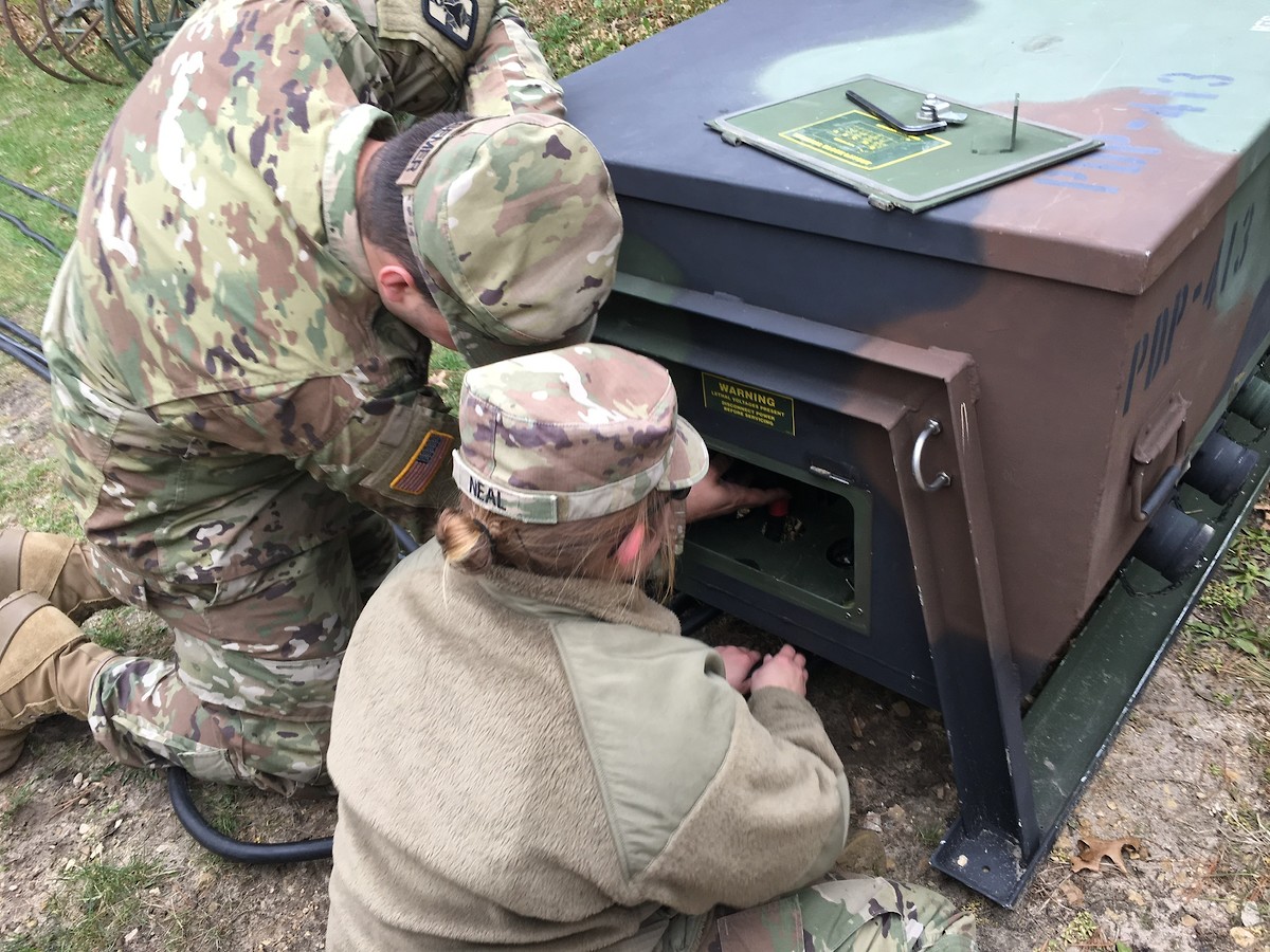

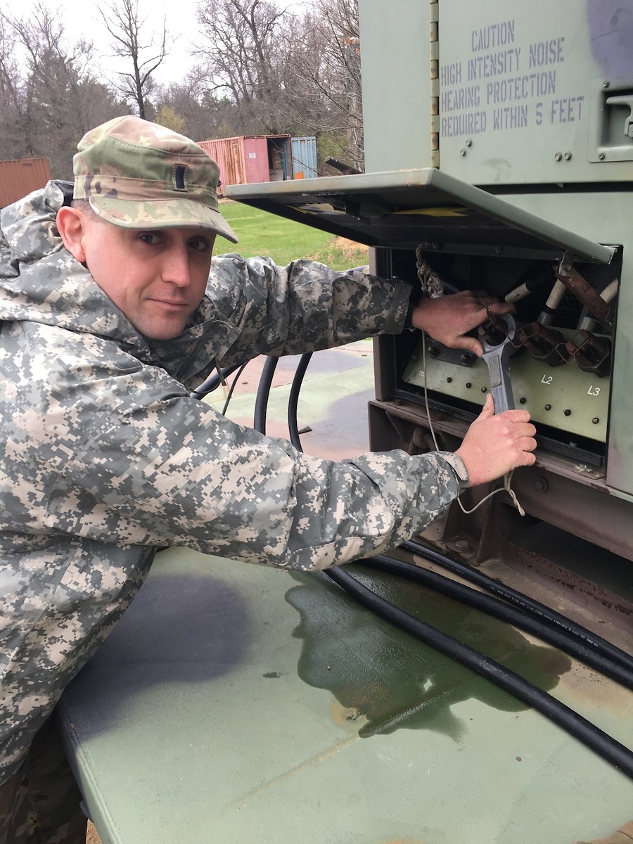

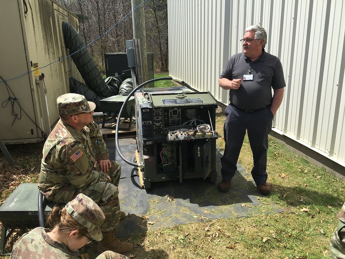

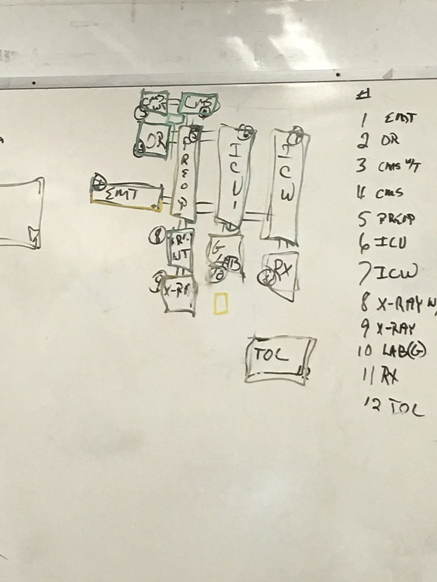

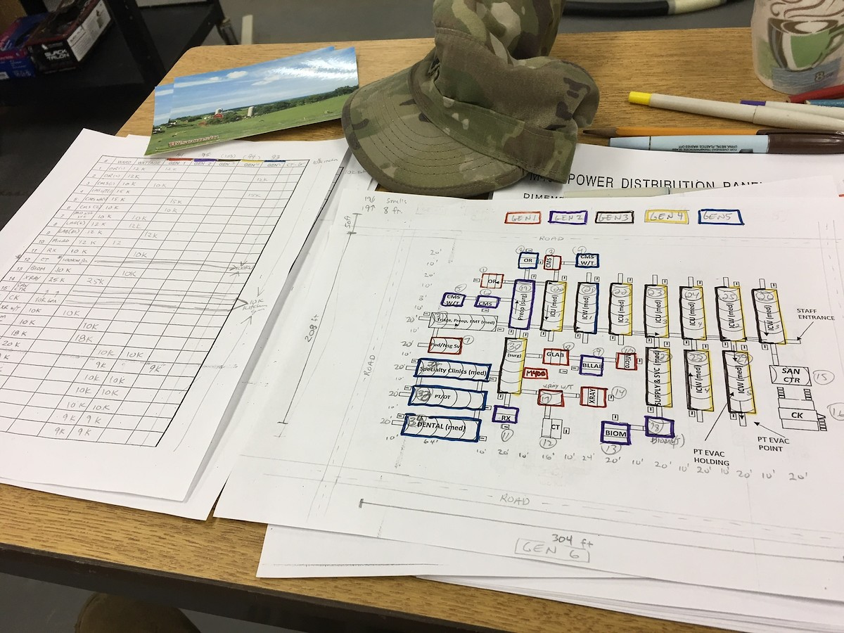

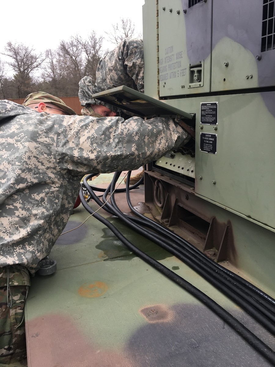

I trained on those early in my army career, we use 100kwh to power combat support hosptials. We do Refreshers every few years to stay ready.
As long as you run them girls hard and don’t let them wet stack they’re great. But when you’re running less power than you need they can be problematic.
6/26/2021 8:34am
TBH this was some of Best training I ever had! He who controls the grid holds the power! Amazing what you can barter by giving some extra juice to the TOC for a coffee pot.

$800 seems like a steal, do you think this is a reasonable option for regular folks over a Big box brand?
6/26/2021 3:55pm
I will say those generators are very well maintained in the military. Surplus price for $800 is a steal, if they have the maintenance log that will make the deal even sweeter. But They keep tight books on them. Atleast for our CSH we are very stringent on the maintenance.
2 things in the combat hospital that will result in mission failure
1. No power
2. No blood in the blood bank.
Rest of it we can pretty much get by, innovate and save lives (to a point) . But we need blood and power to get it done
Those things can get thousands and thousands and thousands for hours on them reliably.
