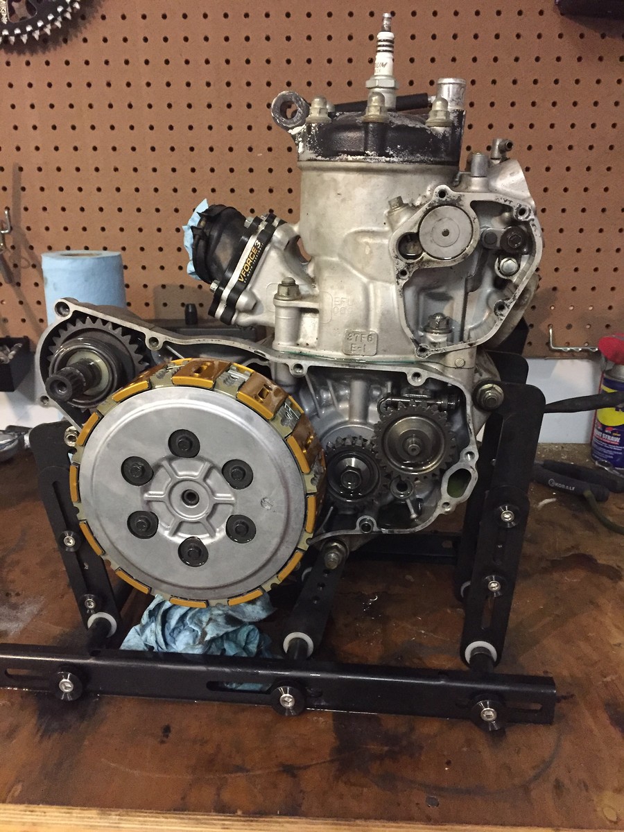

Ok so I've ridden this bike twice in two seperate hare scrambles. So about 3.5 hrs total. Each time I rode the bike I changed the oil and there was a bunch of metal flakes and the oil was trashed. I got a Rekluse and put new fibers and steels in because I figured it was clutch material in the oil. After one ride I drained the oil again and it's still flaky and black. So I pulled the motor and need some direction on what could be the issue. I thought it might be the oil seal but the bike doesn't seem to smoke to bad and it runs great. The power valve is dripping with oil as is the exhaust port, but I've been running 110 at 32:1 yamalube. Any ideas where to start?

Did you consider spinning some ATF through it to help loosen the crud? It may take a few rides to get the gook out.

Yeah I think I'm gonna run some diesel thru it on the stand for a minute or so and drain it to loosen up the crud.
I may have over reacted when I yanked the motor but at least I can run it through the soda blaster while its out haha

Nice engine stand!
If it were my bike, I would rip it all the way down and inspect all the bearings and the tranny.
1/22/2016 10:28am
I bought a 05 CR125 once and the oil was so black it was like tar. I must have changed the oil 7 or 8 times and also flushed it with 2tgas 3 times. The oil was getting better and better each time but was still filthy after just one ride.
Just keep changing the oil often.

Nice engine stand!
http://www.mxenginestand.com/
Normally I would split the cases but I'm gonna give the diesel treatment a shot first to save some time. If I split the cases then it's going to end up costing me big money...haha

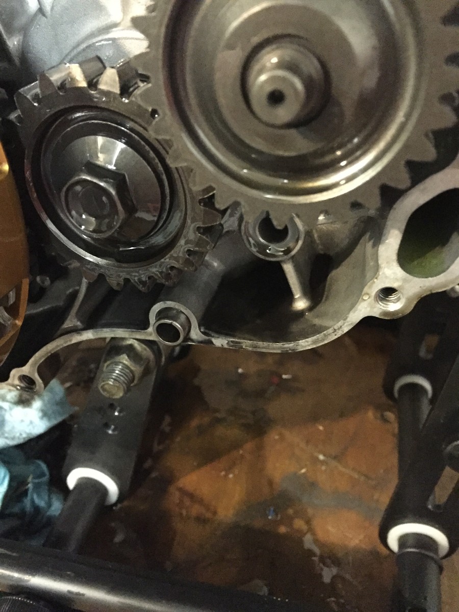

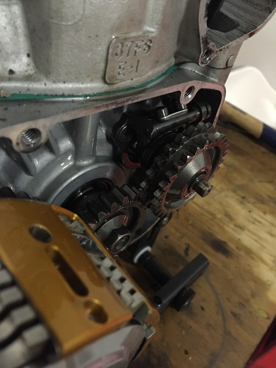

Well I've been stagnant due to work and laziness. I went out to start putting the motor back together with some trick new aluminum bolts and was having trouble getting the clutch side case back on. After wrestling with it I found this
so..I had to order some parts. Looks like it's been that way for a minute.

Got the motor back together last night. Just need to get my seat cover on and my extra wheels laced up
