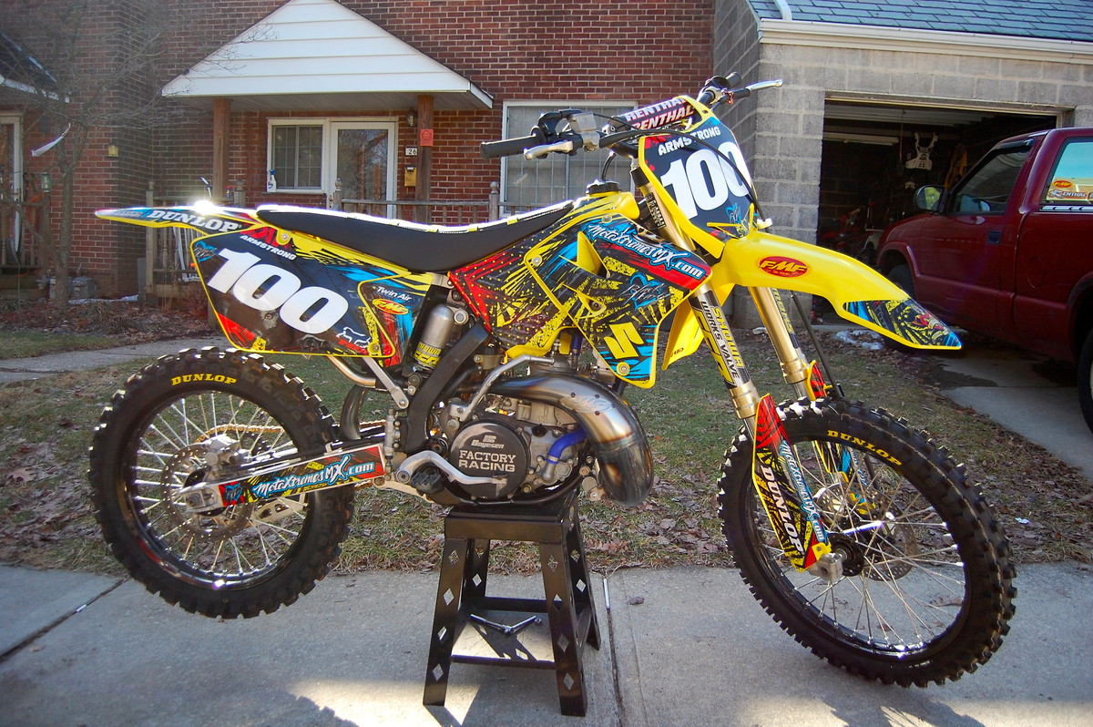

I rebuilt this old girl over the winter. Its an 04. I got to ride it for the first time last weekend. I haven't had that much fun on a bike in years after riding 450's for so long. I still have a 450 to race this season but I just wanted a 2 stroke to have fun on. This thing turns better then anything I've ever ridden.

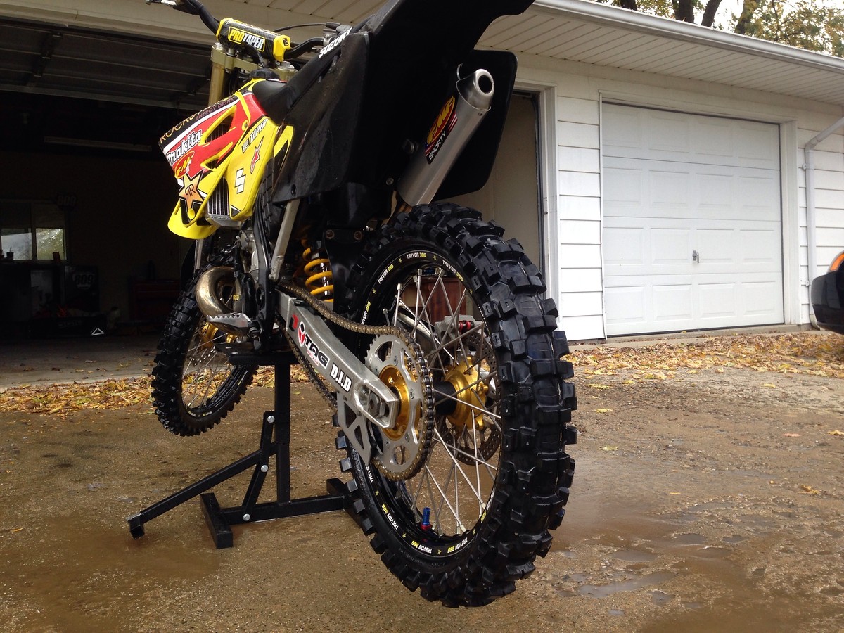

I have a few, this is my latest toy that I built over the winter, 04 and up are all good, 05 has the newer showa suspension on it, but the best overall package is the 06-08 because of porting, But they are all good

^^^^^ I'm suddenly searching for an RM250.^^^ Great pics!. Smile
That is outstanding!!Woohoo

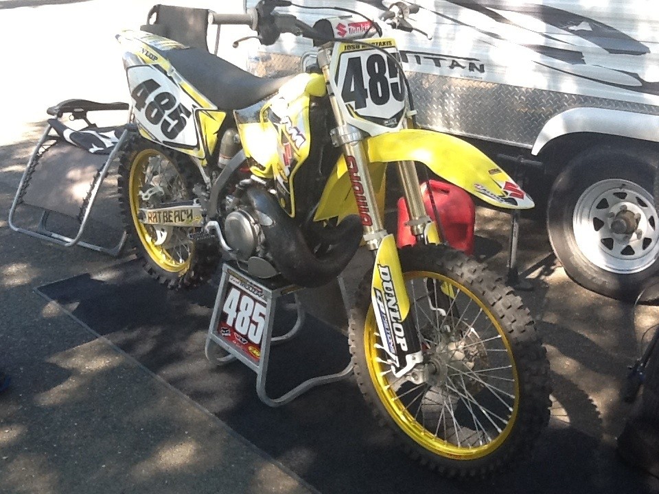

My 2008 which I recently sold......and miss...a lot!!
One of the best bikes I ever owned. As others have said, the later model 250 was a very refined bike. Very easy to ride, smooth power and great suspension.
My friend has a really fresh 04 and that is a different animal entirely. Abrupt, snappy power with a more barky exhaust note and suspension that feels a little harsher in the small choppy stuff. It's still a really good bike though and a fast pro might even prefer the 04 engine over the later models?

Thanks, it was def rough when the work began... took alot of work to get it to that point thats for sure
