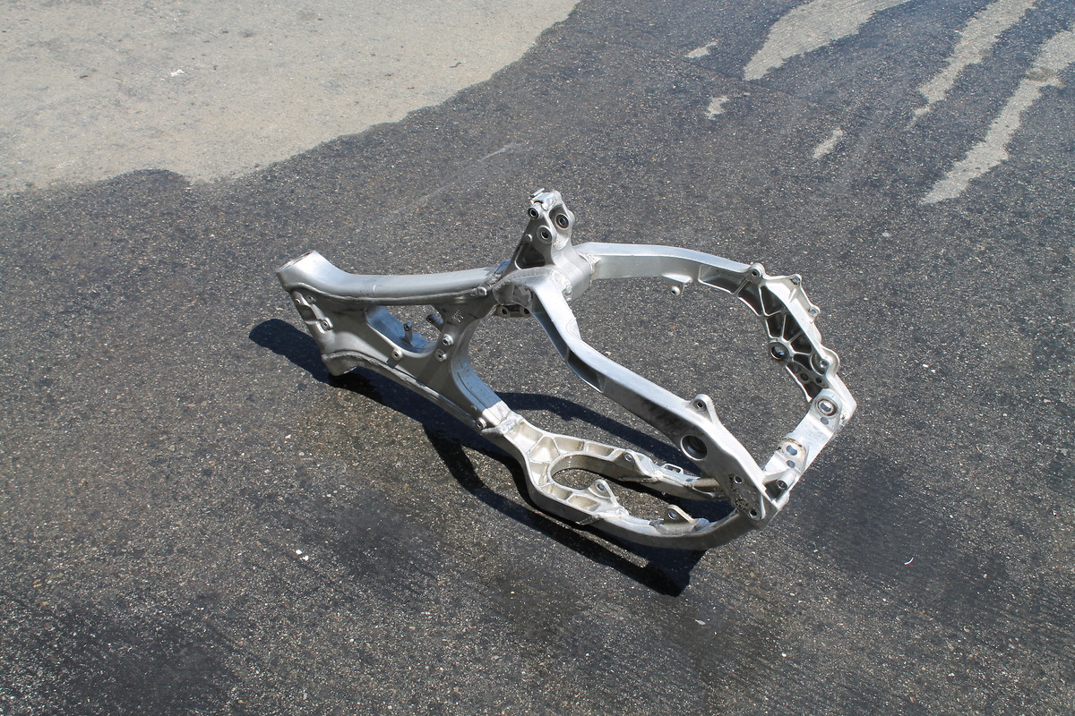

9/19/2017 8:57am
I don't know why more people don't powder coat them blue like the old steel frames.
Frame is on it's way to San Diego Powder as we speak. I think you'll appreciate the result Cool
Awesome thus far - Congrats! Blue on the frame, a la the 2004 Japan early edition?

Thanks, boys. Little more progress to share. My OCD ass ended up re-bead blasting some parts and coating them different colors when I had gaps at the shop. But nonetheless, all the Cerakote parts going on this bike are officially done:
Also, we got the swingarm back. Turned out pretty sharp. Gonna be a bummer if we have to put graphics over it, but if we do I'll see if they can at least do a clear backing. Here's how that turned out:
Should have the frame back early this week. I'm interested to see how that blue turned out. Once we have that back, we can start actually building this thing up and making it look like a bike again. That's it for this week though!

10/3/2017 12:57am
FiendzCC wrote:
[img]https://p.vitalmx.com/photos/forums/2017/10/02/217882/s1200_IMG_2827.jpg[/img]
Super nice blue color!

10/4/2017 7:37am
Great work so far! I like the blocking out of bolt holes on the frame prior to coating.

10/4/2017 10:03am
Thanks guys. We're getting antsy to start spinning some wrenches. Just busy spinning wrenches on other people's stuff this week haha.
And yeah, San Diego Powdercoat knocked it out of the park on this! They do a lot of frames, and are moto people themselves so they know what they're doing on this sort of application.
