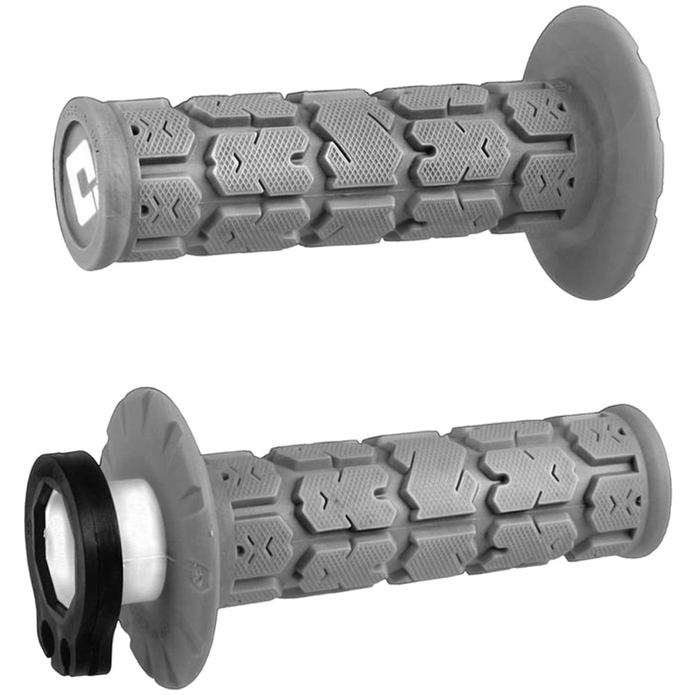

Soft grips also help, stay away from half waffle.
image 3106
ODI Rogue Soft Compound Grey 2T/4T Lock On Grips
