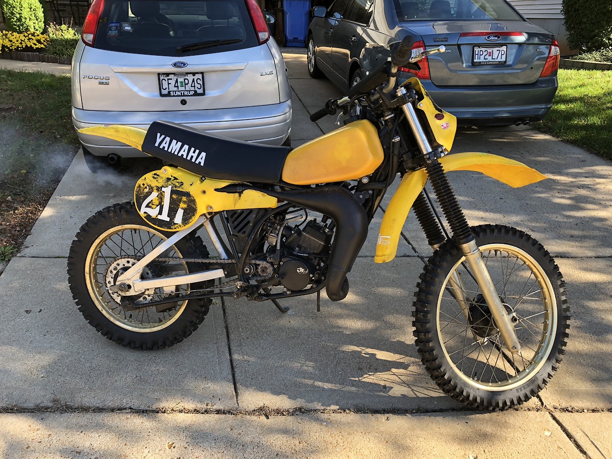

I just installed a HPI ignition system on my 1981 YZ125H and it runs like a bat out of hell!!! I had used my original electrical system following a restoration project and it melted down on the first ride. Following a Ricky Stator install and a 2nd used CDI install, with mixed results, I found and ordered a HPI system. Bingo! It was just what the doctor ordered!!! Runs like a champ now!

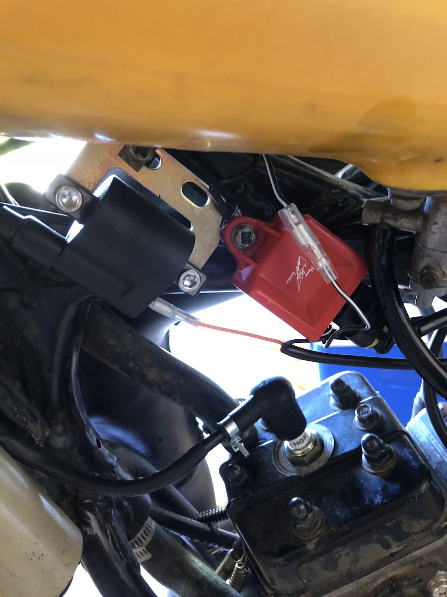

Here’s some pics.

My original stator melted down after restoring the bike. I guess old electrical is bound to fail. I ordered a Ricky Stator stator and it would start, but not run when rolling on the throttle. I bought an extra used CDI unit, it it did the same thing and the coil checked out with a multi-meter. I gave up and looked at PVL and then I saw the HPI ignition systems on DC Plastics web site for $279, so I ordered it. The stock flywheel uses a woodruff key to position it, but the HPI flywheel does not have a woodruff key groove. It was a hassle to get it positioned right, but once done, it fired right up and runs great!

That’s why I went with the HPI system. I started with a new Ricky Stator stator, but it would idle and die as soon as you tried to roll on the throttle. I played around with swapping CDI units, etc., with no luck. So, I decided to get all new stuff that is designed to work together.

I’d get the HPI system. It’s completely new, so you know what you’re dealing with.
