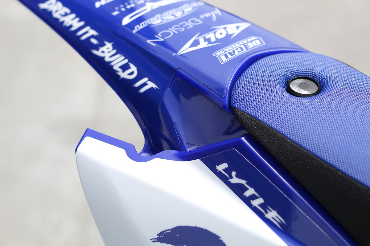

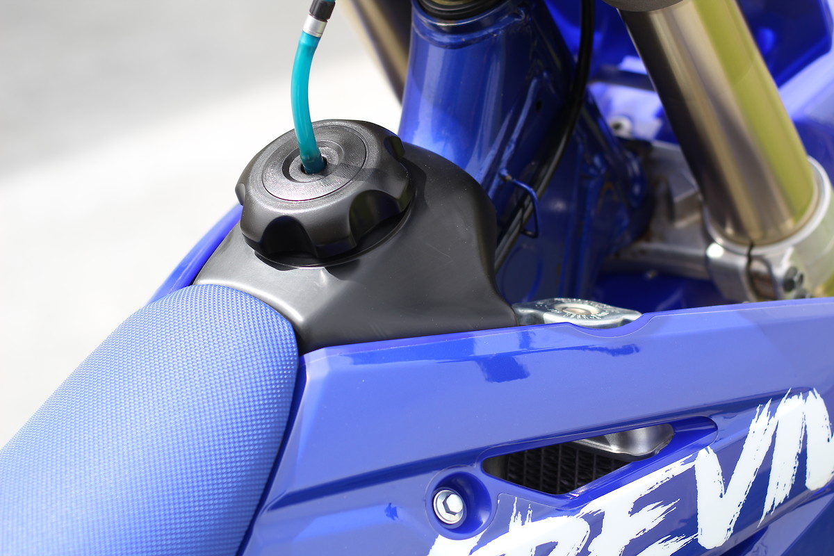

I recently converted my old 2003 steel framed YZ250 into what looks like a 2022 model using all the newest OEM body components. So I thought I'd share all my findings for others that wish to do the same.
It's very easy as some may have already guessed & there is really only one caveat for steel framed YZ owners. You have to remove a little material from the subframe for steelies. Video details where to remove a little aluminum.
What you'll need to convert your 02-21 YZ into a 2022 body equipped beauty:
Quick note...
-This is a list of OEM's you need that will pair with some of your existing YZ's fasteners.
Example: Your 2002-2021 rear fender uses two threaded inserts & bolts on the upper & inner fender-to-subframe mounting locations. One holds your silencer too, for reference.
However, on the 2022 model, the rear fender uses 4 of these fastener setups instead of 2. The rear number plates are now bolted to the rear fender below the mounts I previously spoke about above.
So if you're ordering based off of my list, be sure to add the two extra bolts & fasteners if you want to replace & not re-use your existing stuff.
Long story short- mind the quantities of things as you add them to your cart.
I tried to keep the mod as cost effective as possible & omitted "extras" if the old YZ already had them, since most bikes are not "full builds".
I also did not purchase the tuning fork logo/ sticker that goes onto the seat mounting access cap. (see in video)
