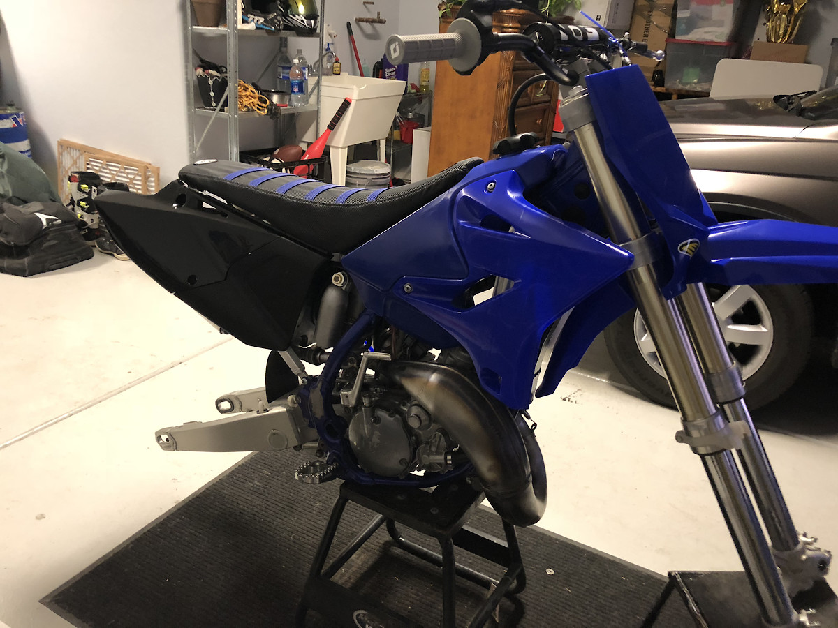

Here it is after hosing it off the first day.
It's about to go down...

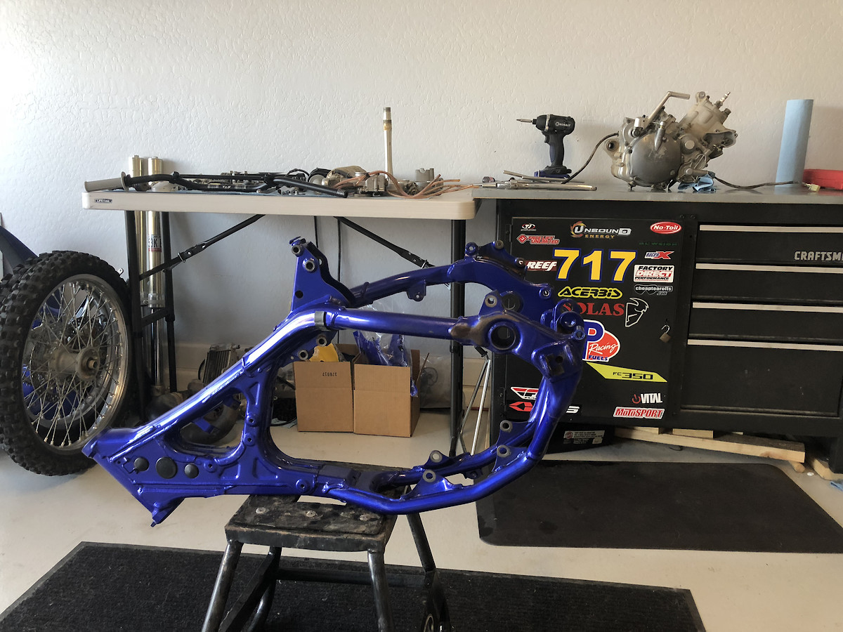

Cleaning and reassembly

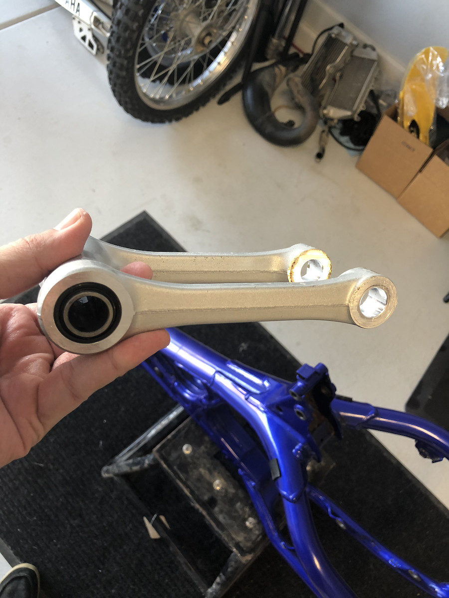

Obligatory linkage polishing (that's NOT a euphemism)

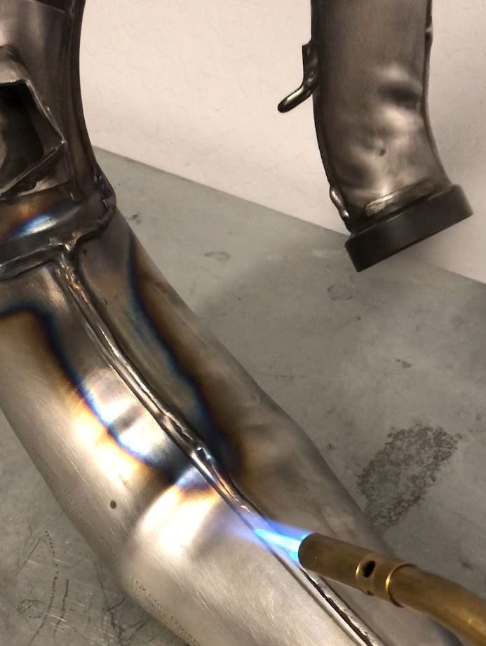

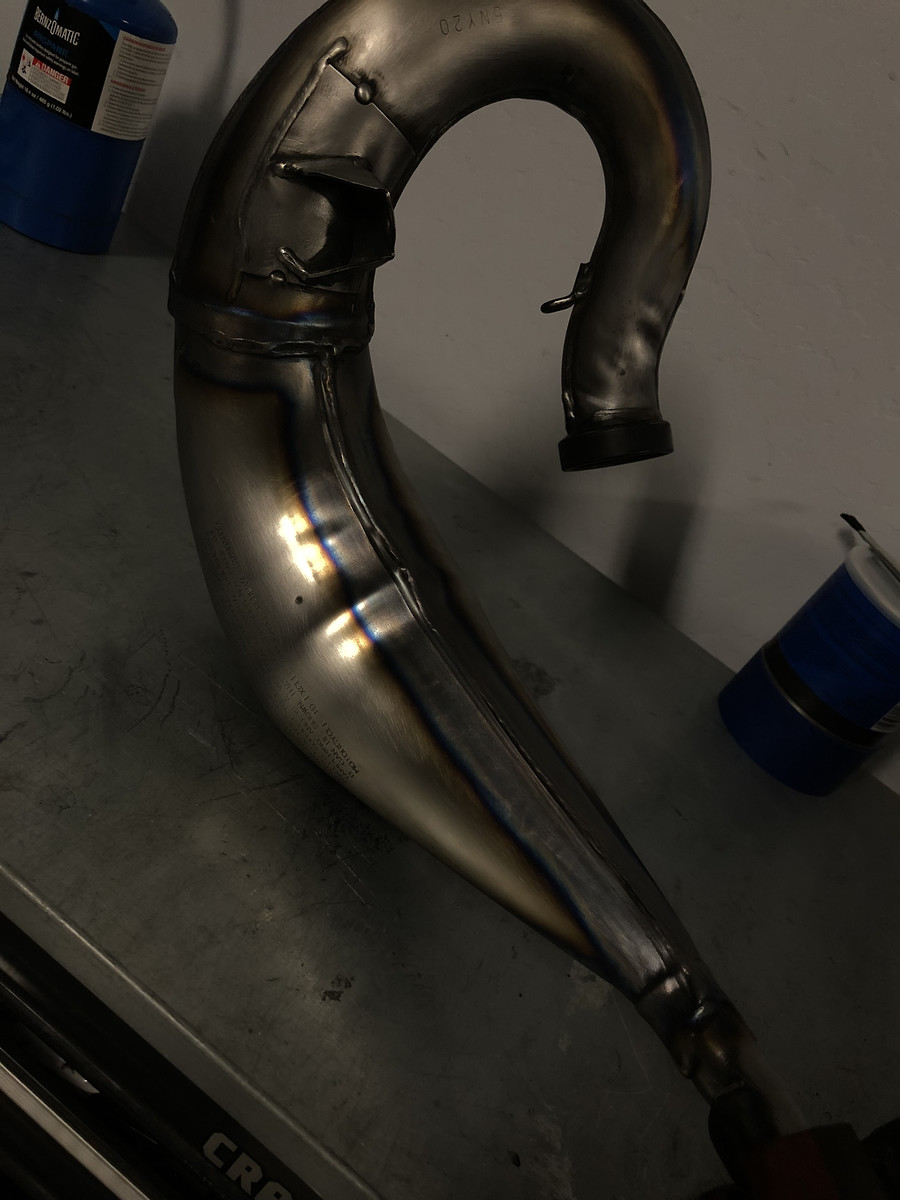

Stripped the stock pipe and blued the welds for that fake fast look

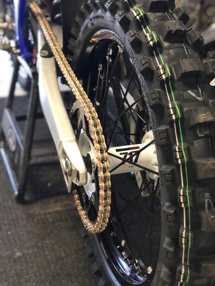

Waiting on wheels Whistling
I've read a lot of reviews/tests/testimonials on "cheap" wheels. These Tusk sets seem to have very high satisfaction rates so I went for it. Pleased with the quality, though the front wheel had bearings for a '14+ axle. Currently waiting on the retrofit bearings.

I think your wheels have spacers to make them fit your bike. Mine came with enough different spacers to make them fit any yz

Yeah I thought one of the 3 sets they sent would work but alas all for the wrong size axle.

Bike turned out awesome. How'd you strip the paint off the factory pipe?
Agent717
587
9/6/2009
Cedar Park, TX, USA
2/22/2018 8:24am
Thanks, man!
It took about two hours of wire wheeling, then another hours worth of sanding and scotchbrite. My fingers were about as raw as the pipe by the time I finished.

Nice budget build. I'm looking at doing something similar soon to an 04 YZ125. What was your process for cleaning up the frame and engine cases? Did you repaint any of the frame? How'd you polish the link? Looks good man!
Agent717
587
9/6/2009
Cedar Park, TX, USA
4/24/2018 5:42pm
Nice budget build. I'm looking at doing something similar soon to an 04 YZ125. What was your process for cleaning up the frame and engine cases...
Sorry for the late reply, I just saw your questions.
For basic cleaning duties I use a generic purple parts cleaner from Ace Hardware. Dont use it on the engine cases though, it will turn them a weird dark gray. I used a little bit of dish soap and water for the cases with a few different plastic and wire brushes. For the big surfaces I threw a wire wheel on the drill.
The frame was in pretty good shape and the only worn spots ware covered by the frame guards so no powder coat necessary.
Used a Dremel to take down the casting marks on the linkage then sanded it down in 3 steps. Finished with a light buffing wheel on the drill.

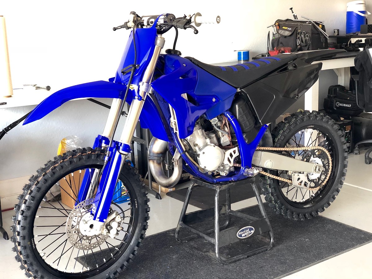

She’s done! SSS and new shock setup installed. Stoked with how it turned out!

So, on the pipe. What was the process on the wire wheel/sanding to get the pipe looking good? Give me the breakdown of what wire wheel you used? brass? silver? Then the stages of grit on the sandpaper?
