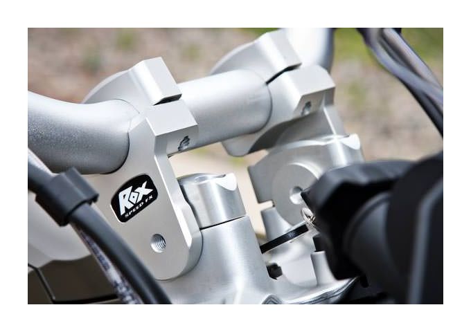

I have traditionally run the Protaper Evo Windham or the Reed/Henry bend. I am 6'4 so the taller bar helps keep proper form when standing. Also I have been using these bars because they have less sweep than others for the rise they offer. I prefer a straighter bar.
I have just purchased the ProTaper Evo SX Race bend that is often recommended to try something different. However I feel I may need a couple of mm of rise. What is a recommended brand of bar mount riser guys like? Ideally one with some rubber inserts to help minimize vibration. This will be applicable to a '24 KX450 and '23 SXF 350.
Thanks guys.
7/4/2024 6:24am
Couple of ways to go about this. You can get full sized bar mount risers like RoX (pictured below) which not only raises your bars but allows for a lot more adjustment front and back. They might look a bit goofy on a dirtbike but I have used them on an ADV and they’re solid. What I probably would lean towards if you don’t need an aggressive height change are just simple risers (more like shims tbh) that fit underneath your stock mounts. Enduro Engineering has a decent set. I haven’t personally used them but my buddy is 6’6 and won’t ride without them. Both the RoX and EE have size options and fit in stock clamps.
RoX Risers

7/4/2024 12:36pm Edited Date/Time 7/4/2024 12:37pm
You’re thinking about this all wrong.  I’m 6’4” myself and do a good amount of winning in the vet B classes for a guy with zero natural talent.  The last thing I would want to do is move the bars up and back toward me.  I run Pro-Taper Pastrana MX (RM low) bend.  Being tall, my arms are long, so the last thing I want to do is move the bars back toward me and up.  I want to make the bike as long as possible to spread my tall frame across the length of the bike.  The Pastrana (a fast tall guy) freestyle bend is tall, but his MX bend is low with very little sweep.  Try this.  You’ll thank me for it.  I was a tall bar bend guy back in the day until someone clued me in on the physics of my situation.

Thanks. I can appreciate that! I always move my bars to the forward position when available. Just looking for a bit more height to make things a bit more comfy. That's why I was thinking a bar riser may help to fill that gap left by not finding a bar with that bit of extra height I want (without being too tall) but without the dramatic sweep many seem to have at the height I think would be good.
7/4/2024 1:01pm
Moving bars to the forward holes will raise them a little bit. Forward holes with risers will be pretty tall. I’m with quadzbro on this one. Try to get along with the lower bars for a few hours before going to risers. I’m 6’2” and run a stock Honda bend on a YZ. I used to ride windhams but like the lower bars in air a lot better.

7/4/2024 3:26pm
I’m 6’5” I’ve always ran renthal windam bend but wanted to try something different so went with a rethal 827 bend which is lower and flatter with a 5mm taller bar mount and works well!

7/4/2024 4:05pm
X trig PHDS mounts have been the go to for me on almost every bike I've owned.
