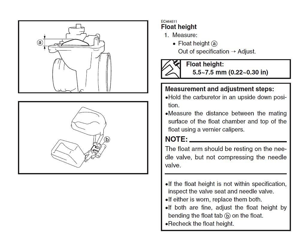

Also, not sure if you're looking at the YZ250 service manual, but there is a specific way to measure float height. Note the part about not compressing the needle valve. If you bend the tab so that the float is level when it's compressing the needle valve the float level will be too low and could make the bike lean.
Make sure you take the petcock off the tank and clean the screen and blow it out too. And make sure the cap is venting well. Test run the bike with the cap off to check.

On my yz125, I ran with and without vent lines and it never effected the way the bike ran but I'll try next time I mess with it. Yep, i set the float correctly, where it's touching but not compressing. It was parallel to the gasket surface at that point. Bike only seems lean at idle. Was actually a touch rich on the main. If it was float height it would lean everywhere, especially when demanding more fuel(WOT). Runs like a champ at wot
