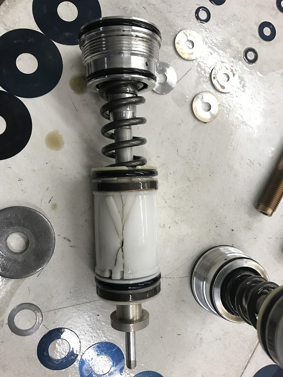

7. It's fairly common for the lugs to come lose on KYB forks. Test for it. They can often be repaired but if they have been ran loose for too long, the treads will be trashed and the tube and lug will need to be replaced.
8. It's very common for KYB SS forks to have cracked free pistons. If they don't, the pistons will most likely be significantly degraded. Replace them with aluminum units. It's also fairly common for the damping rods to lose their Type II coating, taking out the seal and bushing with it.
9. Don't trust any suspension you buy. Take it apart and do a full inspection. And measure the spring rate as well as the length. Make sure you have the right length for your fork, (there are 5 different KYB 48mm fork spring lengths). Keep in mind that some people do some stupid stuff sometimes and you don't want to risk your health. Check EVERYTHING!!
