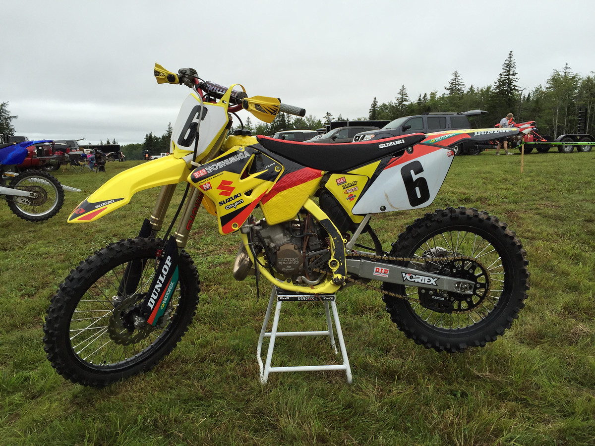

I did both my rims and hubs, here they are after a season and a lot of pulling tires on and off. Use lots of soap and water and be delicate and they last. Hubs are good for sure.
