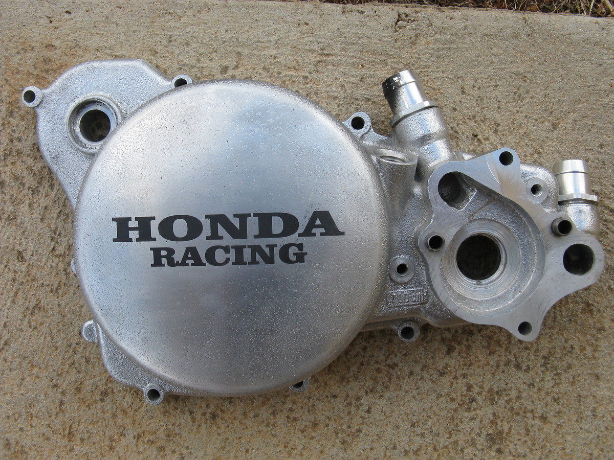

I started out with a 91 subframe and rear end like the Factory 125's had back then. Also someone on here a couple of years ago did the same and made a great job of it. I then thought about a 91 tank as I prefer the shape of the line where the radiator scoops meet. I got a NOS air box for a good price and also new UFO radiator scoops and side panels in red cheap. I had the shock re-oiled and gassed. I anodised the fork caps blue and when I removed them the sliders slipped out and 'peed' fork oil all over my garage floor. So I changed the fork seals at the same time and thoroughly cleaned everything inside. I don't think these forks are too bad though most other people slate them. I had the frame powder coated to match my 86's by my friend. Stripped the wheels and had the hubs powder coated , new wheel bearings and the spokes re-plated. I re-built the brake master cylinders and callipers and had them powder coated. New HONDA RACING clutch and ignition covers. Blue seat cover from a guy on ebay in Thailand. It was a bit tight to fit and had to leave it in the sun for a couple of hours to soften enough. Rear mudguard stickers from Frank at Evo-mx and radiator wing stickers from Paul at MX Legends both in the UK. New chain and sprockets. The bike was in very good condition when I got it and as it is my play/practise bike and I don't ride that much I didn't go too deep into it. I wanted the colour scheme to mimic my 86's but the other details, stickers etc to be like the 90/91 bike. I'm pleased with how it's turned out. It drew a lot of attention at the track at the weekend.

Nice work, did you have any water pump issues? What did you do to your lower fork tubes?
