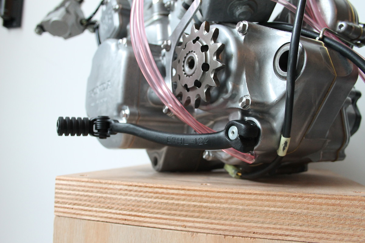

Update on my RC 250M build. After spending time chasing parts are here what I have been able to get a hold of since last update.
Hinson clutch cover. Never before been fitted on an engine.
Engine taken apart and ready for ultrasonic cleaning.
Engine ready. Fully gone through, new bearings and seals, HRC gearbox, all engine parts ultrasonic cleaned and all bolts are replaced by HRC titanium and aluminum bolts.
Factory Honda 02-07 RC 250M swingarm. The most striking feature is the CNC machined brace up front to achieve a more ridged setup.
Factory Toyo radiators. They will need a lot of TLC, but will look like new again once installed on the bike.
Hope you guys enjoyed the update. Other interesting factory parts on the way, please make sure to follow up on future posts.
