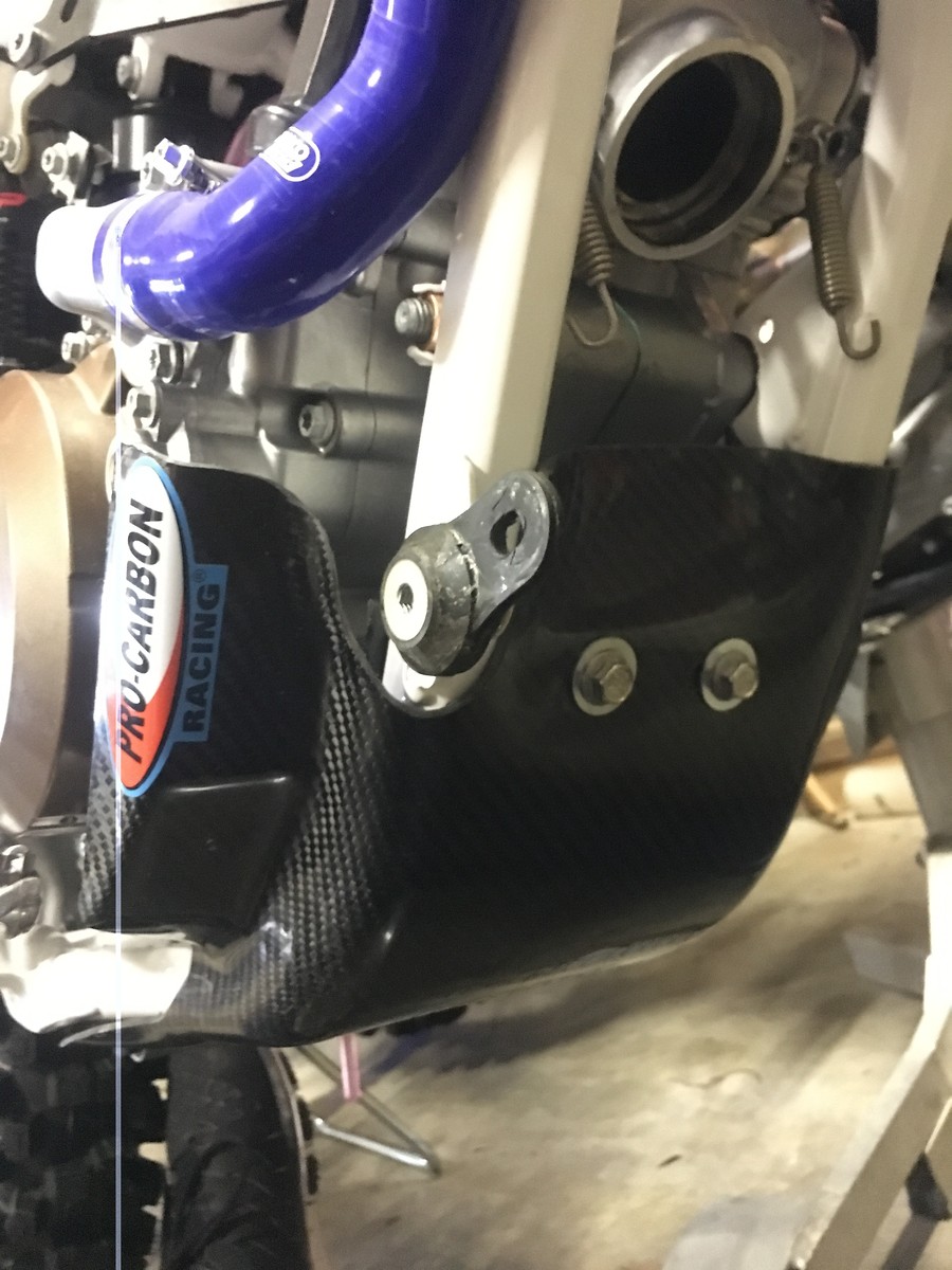

Pro Carbon Skid plate turned up from the UK. Much thinner and lighter then a P3 I had for my 450. In my opinion, better finish too. I did have to drill out one of the mounting holes a little further to the side in order for it to fit.

Hey JC......doing awesome on your build brother! Quick question about the " Pro carbon " skid plate. Was the company pretty easy to deal with and what did they get you for the shipping ? I just sent them a message about trying to pick up a skid plate and a set of the taller frame guards.

Hey Jeffro,
Thanks for the kind words. The fluro yellow really pops in person.
Pro carbon were very easy and efficient to deal. Shipping was pretty reasonable too, about $14USD to Australia from the UK.
