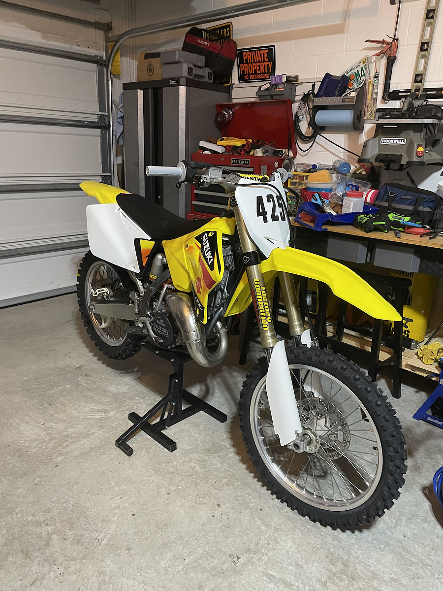

Hey guys figured I'd post up a thread on rebuilding my 07' rm125, just recently got the bike and thought it had a motor failure but ended up being something bouncing around off the flywheel. Oh well, good excuse to build it lol. Will preface this by saying I'm 15 years old and am learning along the way. This is my first bike, used to ride quads but that was 6+ years ago. Only had 4 rides on it before tearing into it, was just riding flat ground at my family's land getting used to it all. The bike ripped, I'm sure that's partially cause I weigh 112 pounds so the bike barley even notices me.
Here's what she looked like before ripping into it. Please ignore the mess, we are about to start moving so its quite messy around. The bike is entirely labeled though, so no worries there about mess.

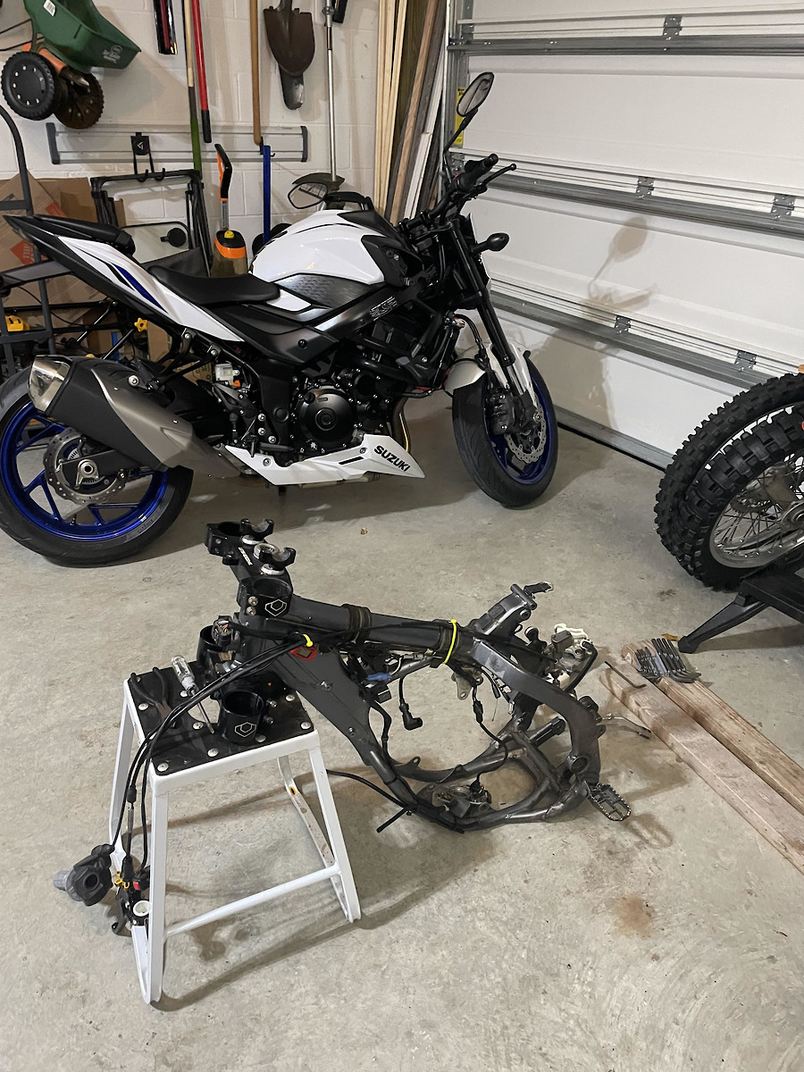

Here's the stage the bike is currently at, frame is getting re powder coated.

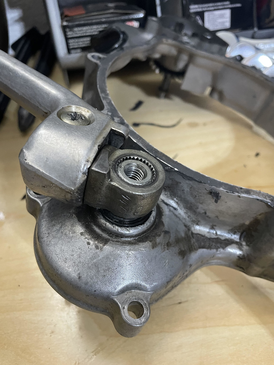

biggest issue so far has been this kick starter, got the bolt off but it will not slide off under any amount of pressure. luckily got off the inner clutch cover without removing the kick starter. Though I'm not too sure how it'll go back on without removing the kick starter It moves in and out a very small amount but will not come off. Any tips or ideas would be greatly apricated.

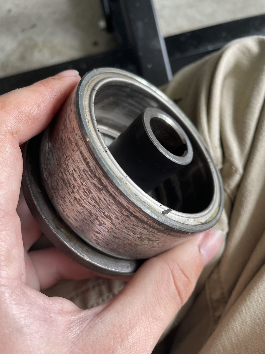

Here's what the fly wheel looked like after the metal object was in there for a bit, should be runnable? Any insight from a more knowledgeable person would be greatly apricated here. Not quite sure what the metal thing even was, looked like a mangled piece of sheet metal. checked many times and nothing was missing in the ignition area. The weirdest part is it didn't cause any issues till 19 hours and a year and a half after the motor was built. Previous owner had the motor rebuilt in 2019. After tearing into it, looks to be around that hour mark. The head had some detonation damage and I am done dealing with the straight ass pump gas that south FL has to offer, so the motor got sent out to Tom Morgan to get ported, along with getting the head recut for vp c12, and some carb work. The bottom end feels in good condition, so my dad wants to leave it together. We already have a new balanced crank along with all seals and bearings to do the bottom end, but my dad doesn't wanna go though the hassle of a motor build. I'm torn on tearing into it or not, as it feels healthy but we already have everything. Any opinions here would be apricated

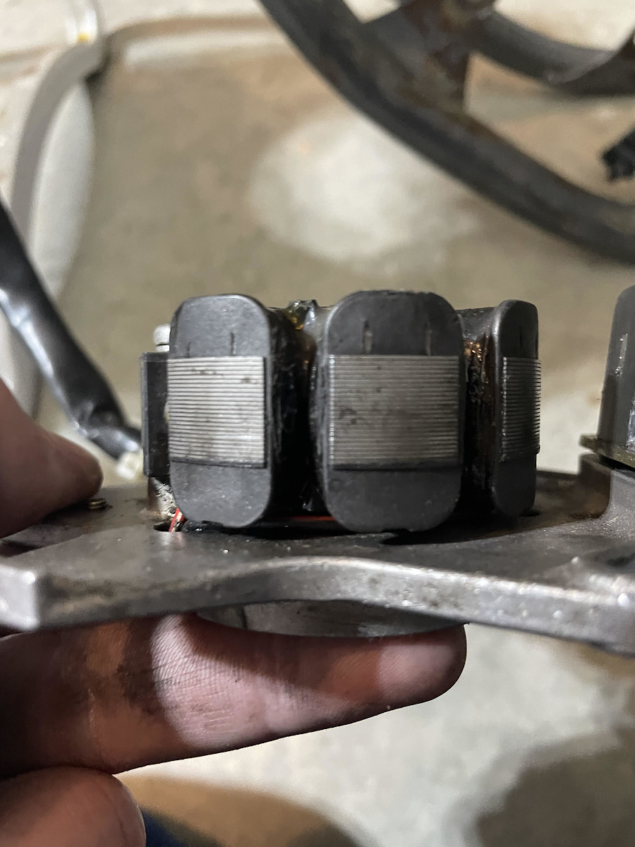

Here's what the stator looked like after dealing with that foreign object bouncing around inside. It was covered in metal shavings but after a ton of electro cleaner it looks to be in fine shape.
The wiring harness is in rough shape and has clearly been re wrapped at some point by someone who doesn't understand how heat shrink works and loves electrical tape. So my dad will be helping me re heat shrink the entire wiring harness while its out. Have some graphics that I designed in motocal so far but am not 100% sure on the exact design. I will say its keeping the 2012 gen rmz front end, and the rad shrouds are inspired by the TP look. Will also be getting a full wheelset from fasterUSA as my current wheels have quite a few seized spokes. The current wheels will be rebuilt at a later date as spares. Thinking about yellow hoops with the "burnt magnesium" hub color. For right now the suspension is being left how it is, it was valued by the previous owner for a 160 pound rider. So its definitely stiff for me but remembering when I rode friends bikes years ago. I much preferred super stiff suspension. We'll see if I keep thinking that way after casing a few jumps, my wrists may want softer suspension lol.

Lots of penetrating fluid and a two jaw puller is what I would try if it absolutely had to come off. Also, I would leave the bottom end in it too for now since there are no signs of wear.

If the kick pedal has some wiggle to it keep working it and hosing it with penetraing lube. It should come off, probably just corroded and full of grime.

Lots of penetrating fluid and a two jaw puller is what I would try if it absolutely had to come off. Also, I would leave the...
Yeah I already blasted it with pb blaster. Didnt do anything. I agree at this point to leave together the bottom end. Thanks

It has sat with pb blaster for just over a week. Didnt do anything. Also hit it with the torch. Yet again nothing, it almost acts like there’s a set screw holding it on the shaft. Not sure. The bike had power loss at the very end and was acting VERY rich even though it was jetted in. I think it was weak spark cause of all the metal shavings on the stator. I think it’ll be fine at this point. Trust me I want to toss some money into the suspension and get it revalved but this bike has already soaked up so much money I don’t have another 800-1000 dollars for that. It will get done eventually, but I don’t have the ability to do it for now. That plus my dad wants me to get used to it how it is and then get suspension done so that I can understand the difference. And understand what changes do what. Instead of doing it all at the same time. Appreciate the response

Can you get a puller on it as previously mentioned? They make pullers for battery terminals which are a pretty compact design but also a little delicate. You may be able to press it out, just be careful to not crack/ damage the case. Little risky. Maybe the splines are rolled from 14 years of kicking? Is the blaster coming from the splines nasty looking?

The PB blaster goes though the splines and is still the yellowish clear that its meant to be. I think its either twisted splines or someone put a set screw in place? No idea why that would be done, I know OEM doesn't have a set screw so my vote is twisted splines. Will try to get a puller on it tomorrow, haven't tried it yet. My dad has a 50T press at work that he used to get out the linkage bearings as they were rusted like crazy. I'd be worried a press would damage either the inner clutch cover or the kick starter gear though

Tried to get the puller on it and couldn't. Any more ideas would be great, as I'm not sure what to do to get this thing off now

Can you pull the snap rings from the backside and remove the cog and gears and slide the shaft through the front of the case with the kick pedal still attached?

I think you would be fine with a press as long as the case was supported well and you are very careful. I don't think it will take much since the pedal is aluminum. Use some heat first. Aluminum grows at about twice the rate of steel. Get in fast with the heat to limit the time it has to transfer into the steel. The case is pretty strong but it is not going to handle any twisting. Make sure you can get a good feel for how much pressure your applying. I probably wouldn't use a press with an electric motor unless you have someone familiar and comfortable with it.

Worst case scenario you could cut it off? Check parts availability before you start sacrificing parts though. Some stuff is hard to find. I've heard the rm's especially.

for the flywheel, the pickup is what matters. show a pic of the pickup on the flywheel

No sadly not, the kick starter itself has to come off. As you can see the gear rides on the inside of the shaft. Has to come out the correct way
the kick starter pivot is steel, and the shaft is also steel. So its steel on steel contact, I'd be super worried trying to press it out. May just leave it instead. Cutting it off would be sketchy, luckily its a 2007 so still a lot of new OEM parts are available. Because of that I am stock piling OEM parts, as its going to be my main seat time bike and get a few hundred hours a year. It would be super expensive to cut off and replace, would rather take it to a machine shop and see if they have any ideas.
