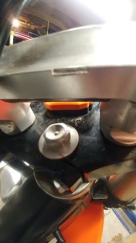

Time to do the steering head, once you've got the back end greased!! Pull the f. wheel, forks, and bars; the bars can come off with everything attached and just set them on the tank area while you pull the steering head. So, pull off the top triple clamp and then the bottom one. ON these KTMs, it's all held together by the one top bolt. Once that guy is out, it ALL comes apart! The bottom bearing is pressed on, so leave it on unless it's rusted up and needs replacing (you'll need a press for that) and the top bearing will lift right out of the race in top of the frame. I also leave the f. fender on too. These bearings are caged and I use the paper towel trick (from up above on the linkage bearings) or you can use a parts washer for better cleaning if available (I'd remove the fender for that). Then, pack that grease in there and make it good! Throw the parts back in place and just go finger tight again. Side the forks in and snug up [b[bottom triple clamps only]/b], mount front wheel and snug up the triple clamp steering head bolt or nut(other models).
Here's my trick for how tight to get the steering head:
I like to snug up the bolt so that the front end will turn all the way to the stops when I barely get it started, BUT it doesn't bounce off the stops.... If it doesn't make it to the stops, I loosen a bit and if it bounces off the stops a little, tighten it a bit more....!! This is how I like it, some folks like to run it a bit tighter for a "dampner" type effect. For me, if it's tighter than how explained, I feel like I'm fighting the steering to get it to turn and I'm half a step behind if things get a little out of shape elsewhere on the track... When you've got that right, set your fork height and tork your pinch bolts to 14ft/lbs on bottom and 17 on top.
Make sure tighten everything up on the bike and then double check it again!!

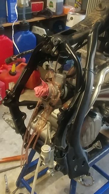

So, while I had the shock and back end off, I took advantage of the easy access and started on the carburetor!
First, a little jetting theory:
As I mentioned in an earlier post, my bike came with a JD kit which has a 30 pilot for the 250SX. So, here are my thoughts on making things "Lean." Lean jetting gives the sensation of "Woah, this baby really Barks!!" But in actuality, you get great sound with No Go. Sounding great while sitting on the stand doesn't win races. The pilot circuit feeds the engine with a continuous flow of fuel no matter where you are with throttle position... so basically it affects everything! If you go low with your pilot jet, your bike is gonna get really thirsty when you ask it to do something with some intensity! Also, off the bottom, it's gonna want to run away with itself. No bueno!
Now, my bike:
Back to the track for testing. Fairly dry, so I wouldn't have much trouble keeping dirt out of things while making changes!
Obviously, I wasn't real happy with the JD kit and I didn't want to buy a Keihin or Lectron carb so let's see if I can work out these jetting woes that everybody is having with their bike. So, what I want out of my bike is a strong pull off the bottom, a really strong hit with a quick fan of the clutch and handful of throttle, along with a clean run out on top! Stock jetting wasn't horrible, but was lacking what I want.
*So, to the brass I went!
*I live/ride at about only 150'-200'
*I started where everybody else does and dropped the pilot to a 40
*I lost some pull on top so I went to a 450 main
*Not much better so I went to a 37.5
*Started running away a little coming into the corners
*Tried a 460. I just wasn't getting the results I was searching for...
*Remembered my jetting theory and figured I was going about it wrong and the pilot wasn't the issue
*Went back to the 42.5 and 440 and dropped the needle
*Bingo, I was really pleased
*Tweeked the air screw a little and loved it!
It had enough fuel to allow that strong hit and had a clean tractor like pull all way til it signed off!! With a little tweek on the air screw depending on elevation, temperature, and humidity, things are really good. It sounds rich on the stand, but put the engine under a load and she sounds great!
I've read many, many post on 250SX/TC jetting and would like to try some different slides and maybe some different needles to get it really spot on! Right now and with Loretta right around the corner (at the time), it was really good!!
If you're running very lean jetting, be careful, too lean is really hard on engines...!!

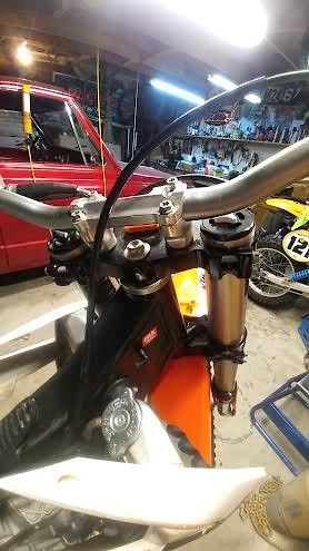

So levers seem to be something everybody is changing these days....
I don't really understand most of the "unbreakable" ones out there.... As most of you have probably seen, they bend back around to the front??? It must help a little, but I want a lever that will bend is the direction that goes away from the impact!!
One of the down sides to the KTM's amazing clutch feel and workability, is a crash could cost you a Master cylinder and not just a clutch perch, just like the front brake side. One of those tabs gets broken off, and you're buying a whole new Master cylinder... That's why I went with the Rental levers, they bend in multiple directions giving me a much greater chance of not tearing up these expensive KTM Brake & Clutch Master cylinders!! The Rental levers have a Great Feel on my fingers and some very nice adjustability to them!! They also come with a nice rubber protector. A nice added touch. I highly recommend a set! I think you'll be very pleased with them.
You can kinda see the small gouge in my clutch side in this pic. A little bit of a nasty crash, but the lever and the Master cylinder and lever are fine!!
This adjusts how far the lever is away from the bar to fit shorter or longer fingers!
You can see these bend up, down, out in front and snap right back in place..... Very handy!!
