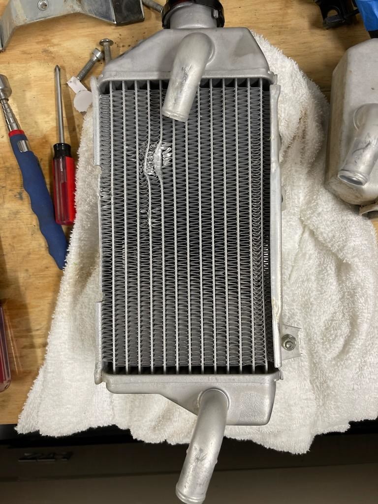

This past weekend a riding buddy had all of the coolant leak out mid moto, severely overheating the engine in his 21 kx450. The bike never seized, but it doesn't sound healthy and the oil is glittery. I'm going to be helping him rebuild it this winter, but I've never rebuilt an engine that was overheated like this.
Anyone have experience tearing down an engine that got way too hot? If so what damage did you find other than piston scuffing?
