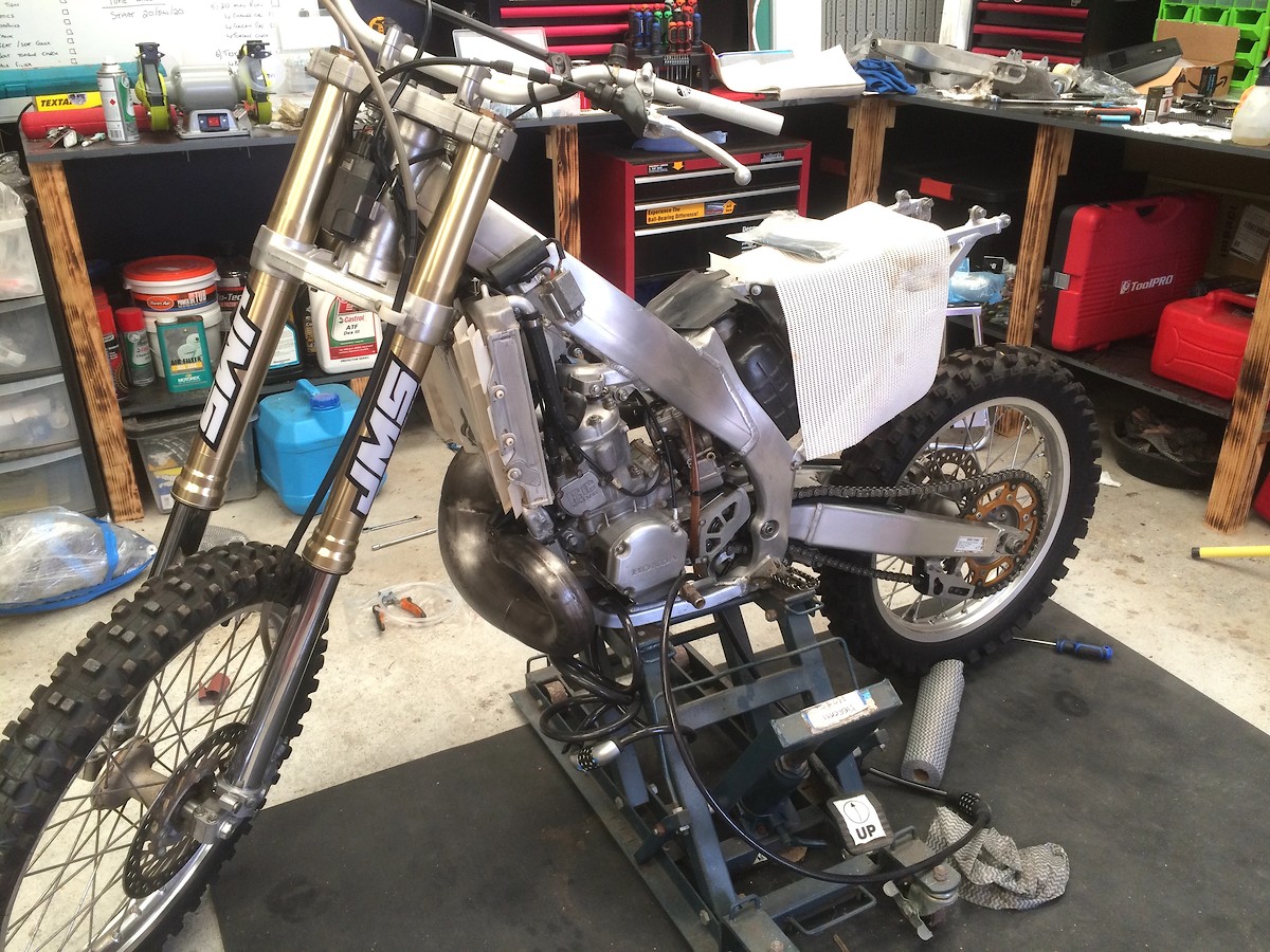

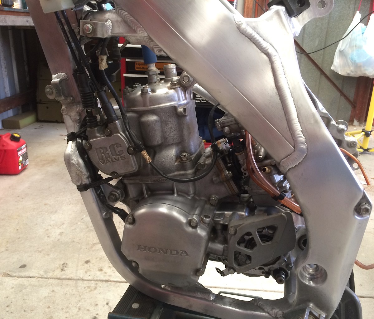

2021 - Now here in OZ it is summer. A big heat wave kicked in a few days ago and total fire bans so no riding. So I thought I would put it back together. Not a garage queen, being built to ride again.

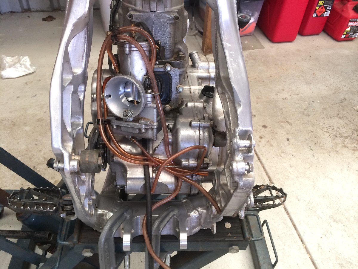

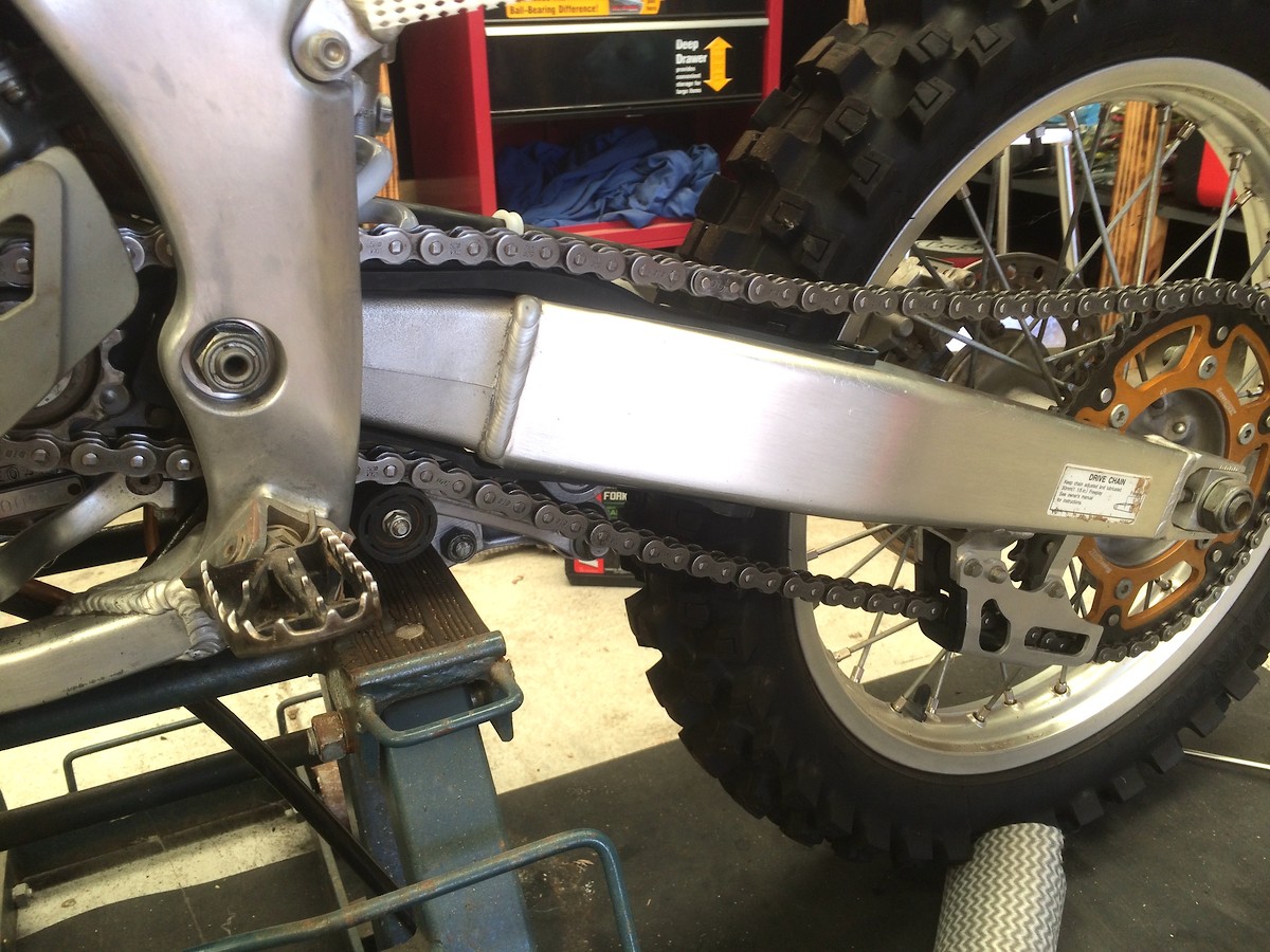

So far, all chassis bearings replaced or cleaned/greased. New brake fluid. Coolant flush/refill, Rear wheel re spoked due to corrosion on the spokes, Original chain/sprockets used from the 2012 rebuild, Forks and Shock serviced/revalved.
37.5 Pilot, stock needle in 2nd position and a 430 main (I know its a little big but there is a ton of sand here in Western Australia)
Cleaned the carb, stuck some fuel in it and she fired up on the 6-8th Kick. First 4 with kill switch pressed to get some lubrication in there.
Ran the bike for about a minute, verified the kill switch worked. checked coolant level. All looking good.
Aim to finish the plastics etc off over the weekend. Hopefully hit the track sometime next week. Waiting on a few parts to complete before I can ride in Anger.

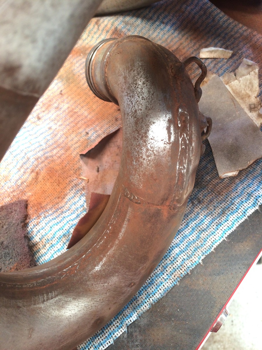

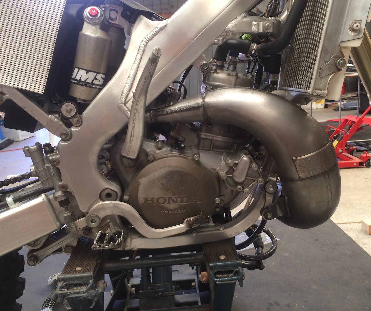

Cleaning the exhaust back up

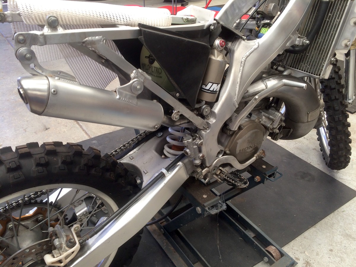

Starting to look like a bike again
