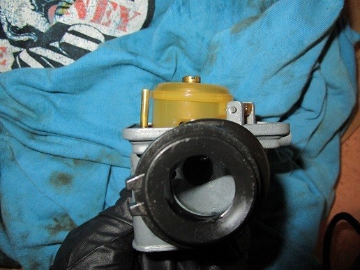

I think the slide (?) is installed correctly? Turning the handlebars side to side doesn't pull it up at all.

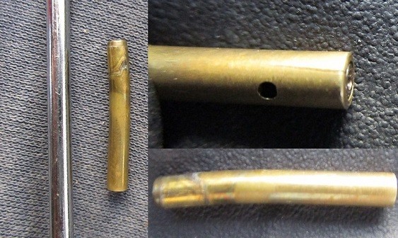

The only other part in the carb that I can see has damage is this following piece. I can't find it on any parts diagrams so I don't think it's possible to order a new one.
It goes through the hole at the top in that last photo down to the opening at the bottom/side of the bowl. That is the "before" photo, it was the only one I had showing that.

The little brass tube is for the choke circuit. As long as it is able to pass fuel, the little bend is not a big deal. It is obvious that the choke works, as you were able to use it in getting the bike running, using the choke on a cold start.

Kind of a pain to pop the box apart, but it can be done. Your first pic looks like the slide is not quite fully closed. Should be just a slight trace of a gap at the back of the carb when slide is fully closed. Check the box, and cable routing.

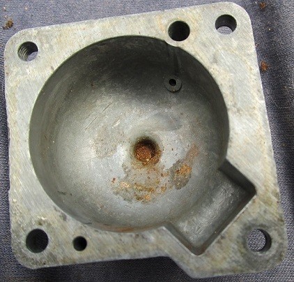

The bowl gasket looks a bit varnished / hardened. I have a few new ones here, but it would probably cost a million dollars to ship it to you.

I have used those Miniky carbs on a couple of PW's and they worked pretty good for me. This one had one ,as I bought it with many missing parts. It ran good.By the time you buy a new needle, bowl gasket, etc from Yamaha, you will have quite a few dollars in the old carb.
There is no float height adjustment on the PW carbs. With the bowl off, hook a piece of fuel line to the fuel inlet, and blow through the line by mouth, while lifting the float up to the fully closed position. If it is sealing, the air flow will stop as the float is lifted to the fully closed position.
