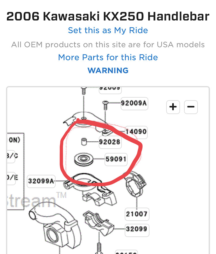

Any ideas where to find a new wheel, I’ve been looking online and can’t find one! Tried my yz250 wheel but it doesn’t fit...

3/15/2019 4:19pm
I took the set up out of my 06 kx250. Looks like they’re available through Kawi.
