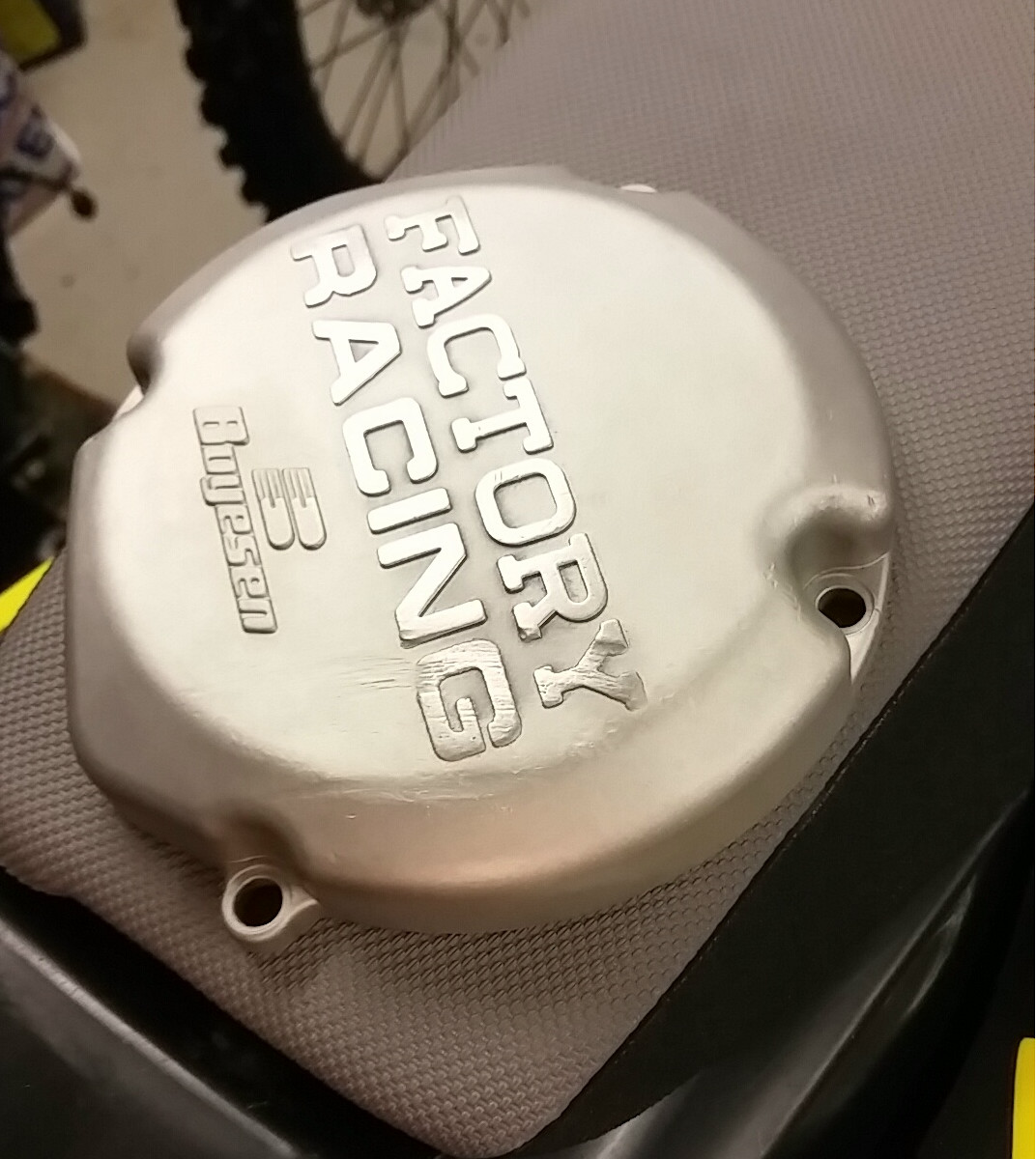

This cover was originally the Boyesen Bronze colour.
I used glass bead media to achieve this finish. Took a while but turned out nice, sort of a satin shine.
Sand blasting will probably leave a rougher finish, depends how coarse the media is.

I second this. Glass blasting is what you want, not sand blasting, although it’s the same equipment. Sandblasting will be pretty rough and could eat through the cover if it’s magnesium. Glass blasting isn’t as harsh and will give you the look you want.

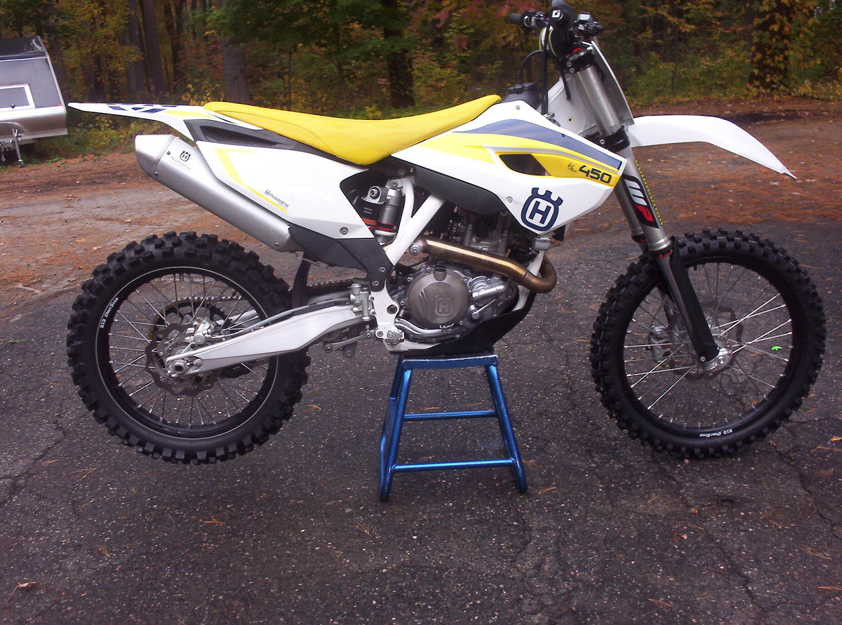

i did my 15 husky with glass bead media, that brown powdercoat on there is tough i burnt it off with a torch first

i did my 15 husky with glass bead media, that brown powdercoat on there is tough i burnt it off with a torch first [img]https://p.vitalmx.com/photos/forums/2018/01/29/240912/s1200_100_4131.jpg[/img]
That looks mint! Is this something you could do with a tumbler or does it need to be blasted with the glass media?

i blasted it in my blast cabinet, and it woulndt touch the powdercoat so i burned it off first

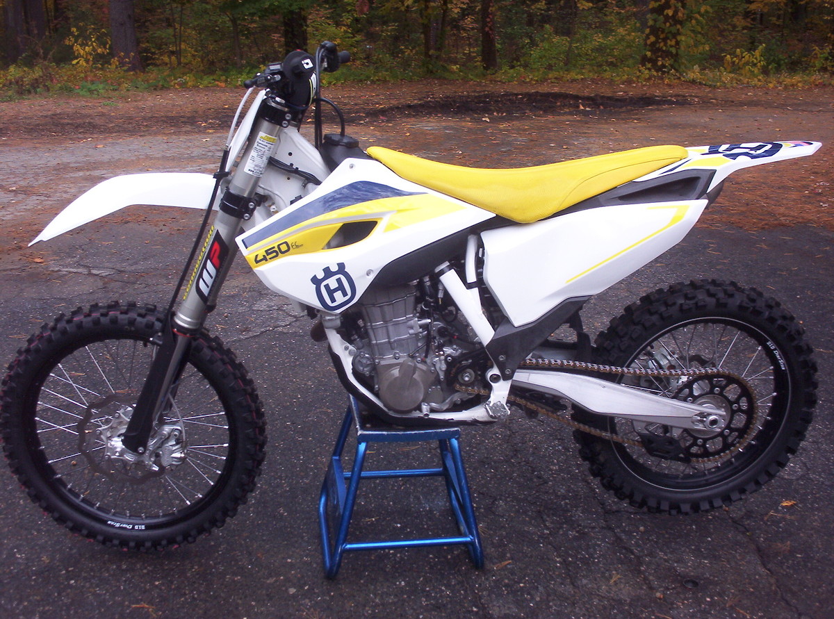

heres the other side and i did the valve cover too , before i ever rode the thing mine came with yellow, it was fugly
