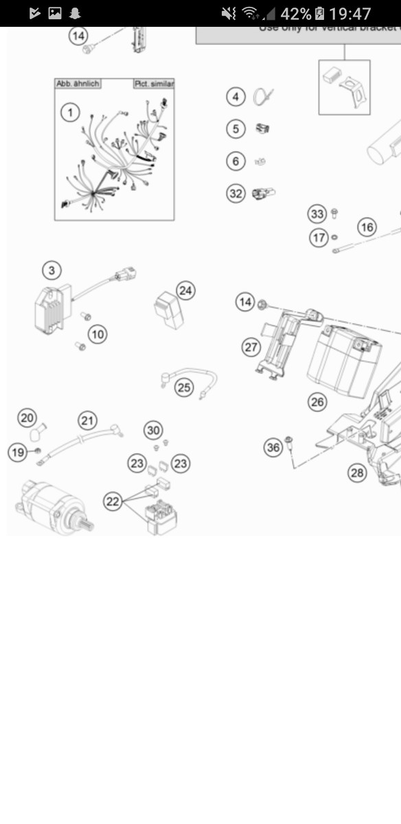

As the title says, my switch wont turn off and its draining the battery. Has any one encountered this problem?
I have narrowed the problem down (I believe) to the relay on the starter solenoid. Im unable to locate the part in in any parts diagram that would make sense.
Any and all help appreciated

I had the problem that my fuel pump was turning on by itself, also draining the battery. I changed the starter relay and it fixed it, not sure if it will fix your problem but worth a shot since it only costs $10.

Thanks a ton. Ill get that ordered ASAP!
