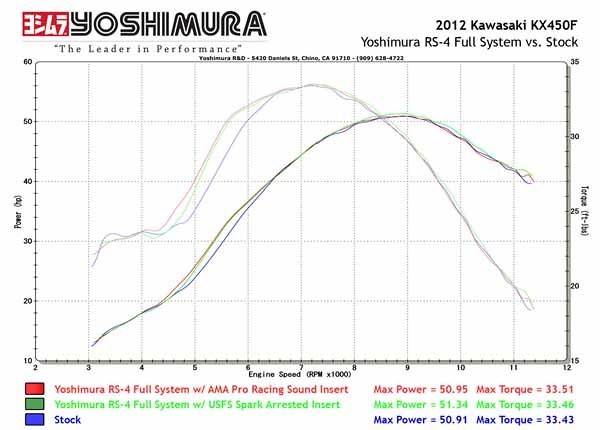

It isn't always true that more sound equals more power. I know according to yoshimura that the exhaust actually makes more horsepower with a spark arrestor in. I am citing Yoshimura's actual dyno results. I would contact FMF directly, I am sure that they would be happy to help you
