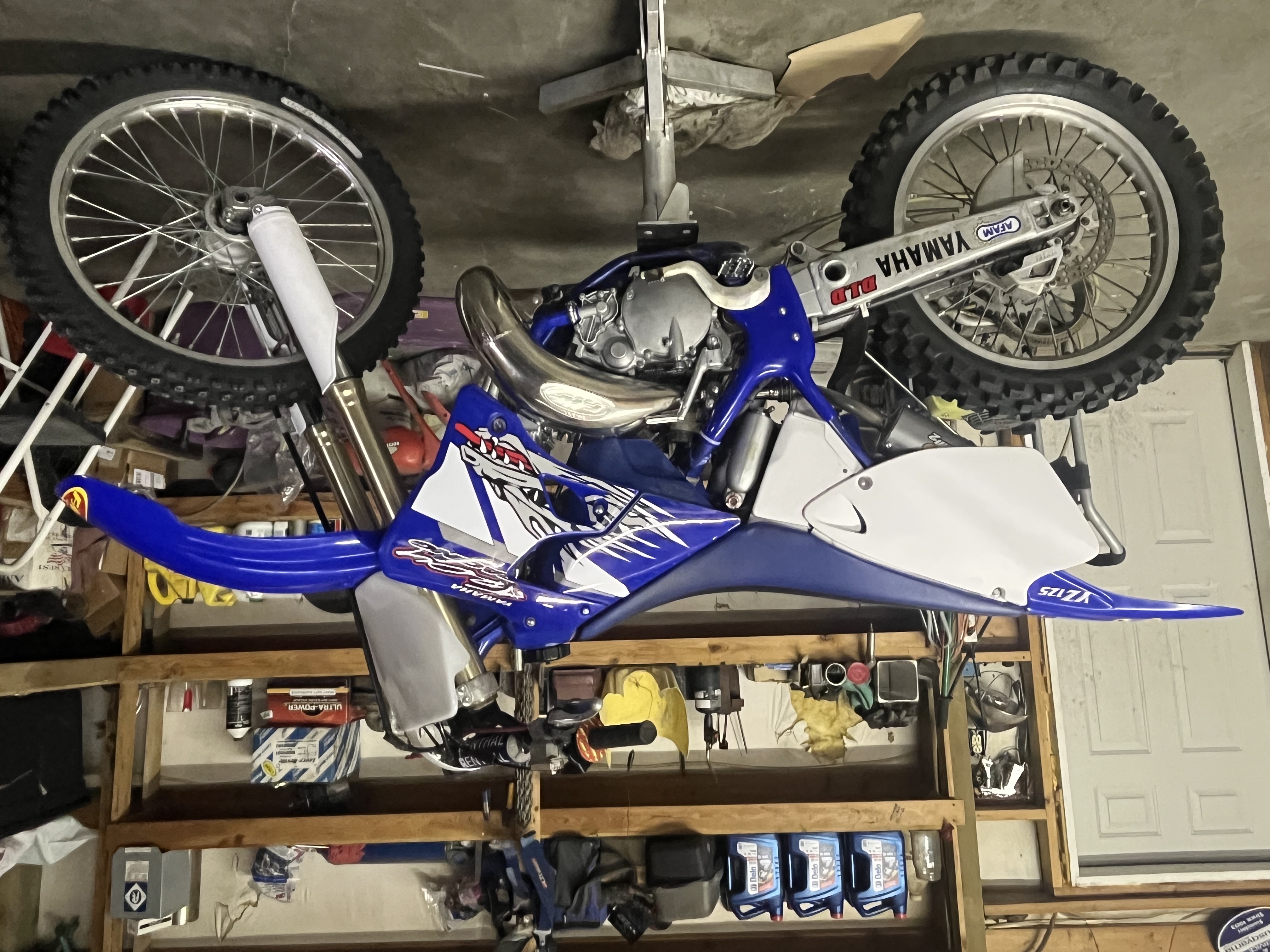

Alright here’s what I found
The 98-02 YZ125 lower clamp and stem is P/N 5DH-23340-M0-00 and is NOT the same P/N as the 250s
The 06-14 yz125 and ONLY 2006 year yz250f Lower clamp is P/N 1C3-23340-M0-00 and also is NOT the same P/N as the 250 smoker or 450
I suppose a measurement on your 08 or 11 125 would be helpful but please don’t pull it apart just for me, I don’t have any oem 2000 yz125 clamps but I do have some terry cable clamps that came on the bike that were attached to some old KX forks so who knows what bike that clamp actually belonged to
long story short I got some 06 CRF250 forks for an absolute steal and I’m looking to mount them properly to my 00 YZ125, the Honda stem is just a bit too long (about 10mm) and the stem in the Terry Cable clamps is too large at the base to press into the Honda clamps
I currently have a 12mm washer or plate if you will making up that space but honestly that just doesn’t sit right with me and would like to atleast have some Yamaha clamps on the bike even if I do have to shim the uppers to make up for that 1mm KYB- showa tube size differential
PS I enjoy watching your go pros on YouTube lol
image 143
4/17/2024 9:50pm Edited Date/Time 4/17/2024 9:51pm

Alright here’s what I found    The 98-02 YZ125 lower clamp and stem is P/N 5DH-23340-M0-00 and is NOT the same P/N as the 250s  The 06-14...
image 143
Keep in mind that stacking different brands of stems and clamps you may get different clamp thicknesses which could cause issues with the stem length.
I have my pal's 2008 YZ125 here to change her fork and shock seals and I have my *2011 YZ125, both are assembled.
Measuring from the bottom of the lower clamp to the top of the stem with a stainless ruler I see 268mm on those bikes.
I have two stems in the drawer, one that I labeled with a sharpie as the original stem from my 2011 YZ125 and the other is from a set of 2008 YZ250F clamps that I put on my '19 YZ250....  Those stems measure about 267.5mm from end to end.
*Currently I have 2008 YZ250F clamps on my 2019 YZ250 and 2011 YZ125.
The 250F Aluminum frame stem is the compatible with the YZ125 aluminum frame.
The YZ250 two strokes from at least 2002 up use a longer stem.
Without disassembling my 250, I measured 275mm from the bottom of the lower clamp to the top of the stem.
Hopefully that helps.  Here's a photo with some stem diameters for the 2011 YZ125 stem.  The 250, 250F and 450F stems share these diameters back to at least 2002 model YZ250s and at least back to 2005 model YZ125. I bet the diameters have stayed the same since models farther back than those years, but I can't confirm it.
