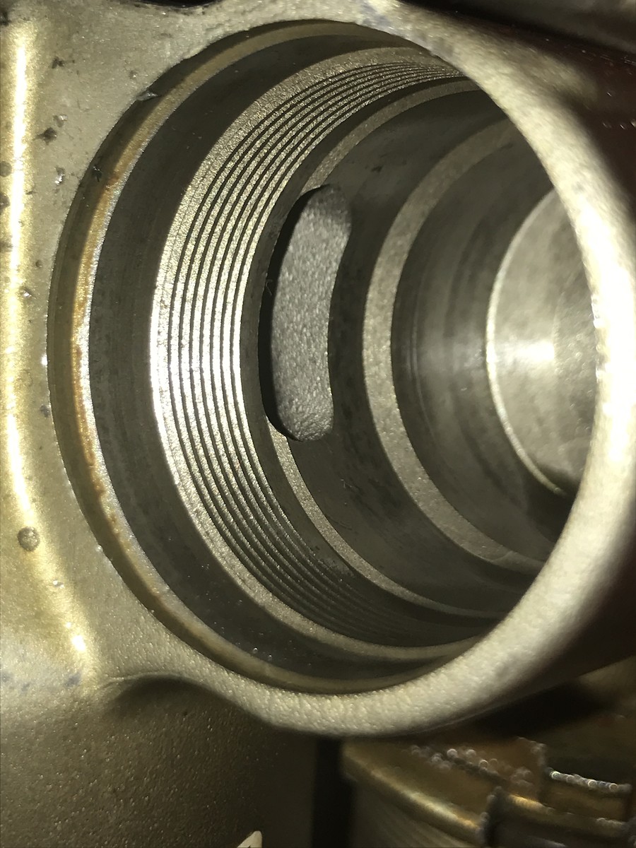

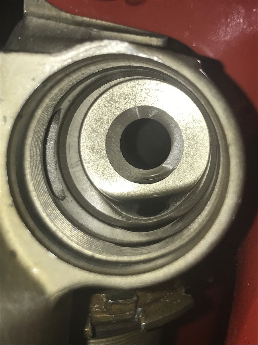

I'm in the middle of testing the fitment of different 4-stroke shocks on an 89 cr250. my plan was to find a shock off of a newer 4-stroke that has the best fitment In the 89 then try and find an a-kit shock to use (will require slight modifications to fit and have somewhat of the same geometry as stock).
Here is a 2012 RMZ 450 shock on the 89 cr250
