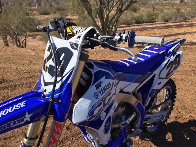

RiverockMX wrote:
Nice Chris, I shoulda hit you up on Proride for info. Lots of fuel on that map! I think I need more fuel across the board...
I think I need more fuel across the board with the extra air I'm flowing. Cycra powerflow kit, screen elim , vented ft plate and FMF Ti4 slip.
ya....his bike was really lean ( lots of decel pop) anywhere he rode. Last time he was at milestone he called me and said it was really bad so I just had him run the fuel up across the board. hes much happier with it now. He rides it very hard so I'd rather it have too much fuel than not enough.... I bought those cycra shrouds but he didnt like the fitment so now they sit....lol...I even bought the fasteners but he just wasnt havin it...
7/13/2018 8:51am
Oh man, the Cycra's were one of the best things I did.. slimmer, cleaner look. Little patience for the install all U need.

RiverockMX wrote:
Oh man, the Cycra's were one of the best things I did.. slimmer, cleaner look. Little patience for the install all U need. [img]https://p.vitalmx.com/photos/forums/2018/07/13/274393/s1200_Left_front.jpg[/img]
ya I'm sure if I took a few minutes it wouldn't be an issue...hes really busy...lol
