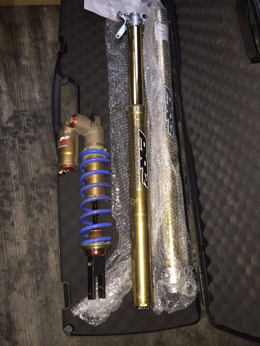

-Suspension, probably my favorite part about the build is I have a set of PC A kit sitting around I am going to put on the bike, I just found a set of Tag upper and lower clamps to put on it from craigslist, not very easy to find upper and lower clamps anymore, I really wanted PC but couldn't find them anywhere. PR2 is going to help me out with getting the clamps to fit the bigger forks and getting the shock to fit perfectly.

Ehum...that's a nice case with suspension you have there that is just laying around lol

I bought it off eBay back in 07 for $1300. I had it on my 07 250F for a few years then got a new FI 2011 bike with the SFF suspension and instead of putting this A kit on that bike I got my SFF done so its just been sitting around not on a bike for 3 years or so, I got a great deal on it and its already set up for me so I did not want to sell it. I debated on putting it on my 2004 PC 250F that was bought from PC back in 2005 but the 125 seemed more fitting for it.
