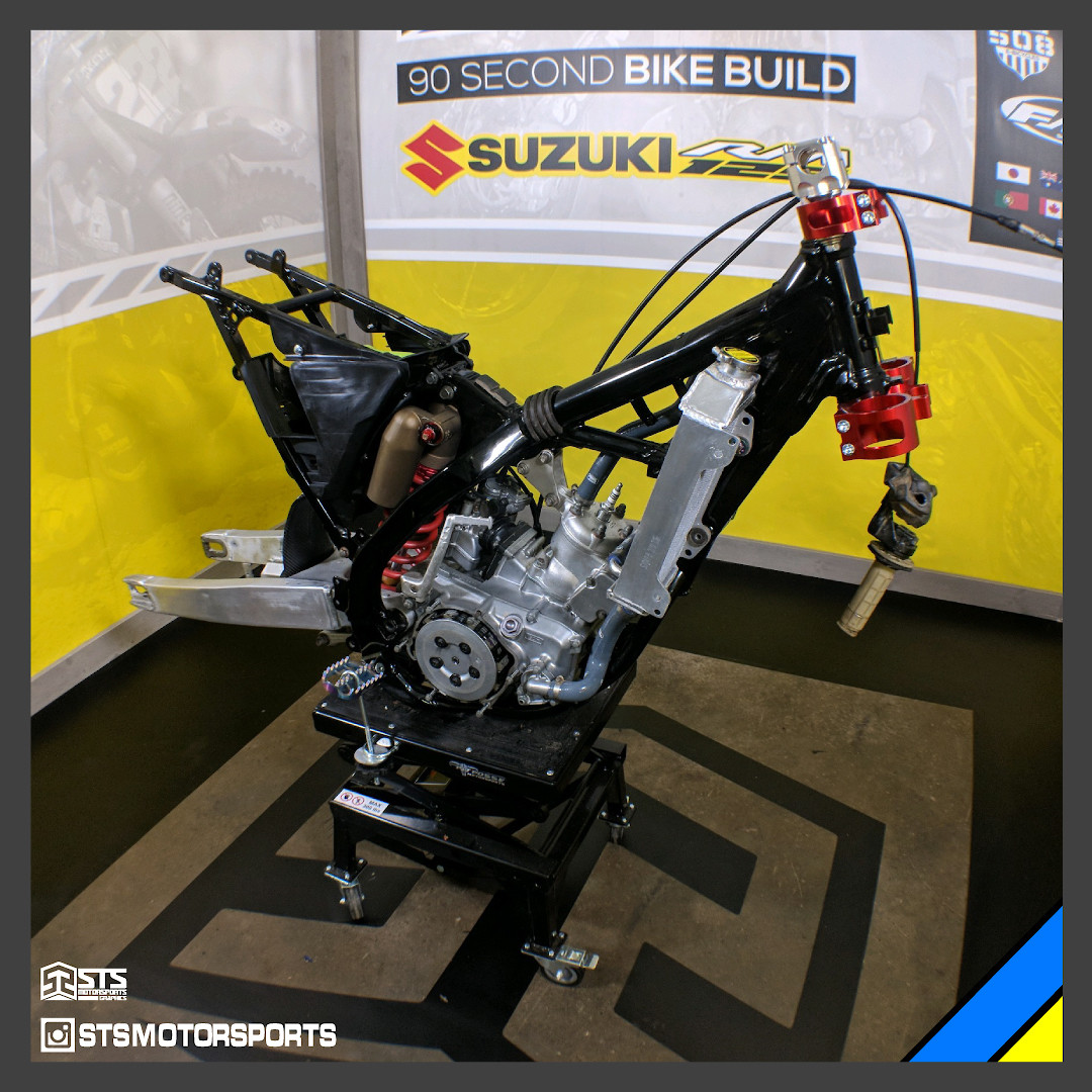

Build Update Pic
Still have a decent amount of work left to do. A lot of the bolts pictured will be replaced with Titanium. I have been working to clean up the swingarm but still have some uneven areas. I will definitely be searching the forum for swingarm finish tips.
Shout out to my buddy and fellow J Day Offroad race Dan Miller for putting in a bunch of work to get up to this point and pressing the bottom triple clamp bearing and DMC Cycles for the help with some grease haha!

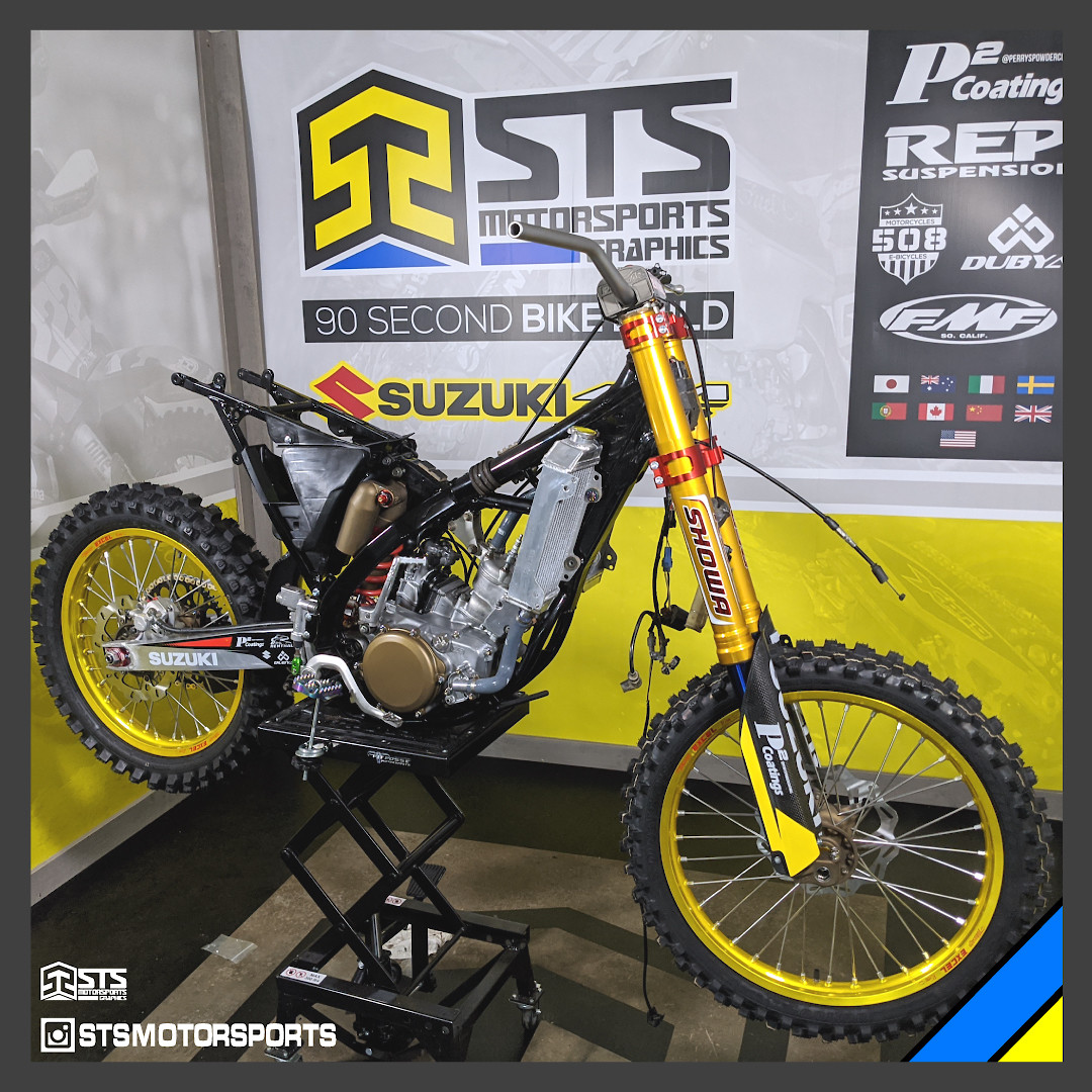

7/28/2020 9:45am
Build Update Pic #2
Wheels - Done
Chain & Sprocket - Done
Titanium bolts, axles - installed
Tomorrow's checklist
MotoStuff Front Caliper
Bleed brakes
Graphics & Seat Cover
Thursday
Handlebars
Install Plastics
Pipe & Silencer
SC1 haha
Have a Finished bike

Triple Clamps are Kite. Mounts are Titanium off of a Factory bike overseas.

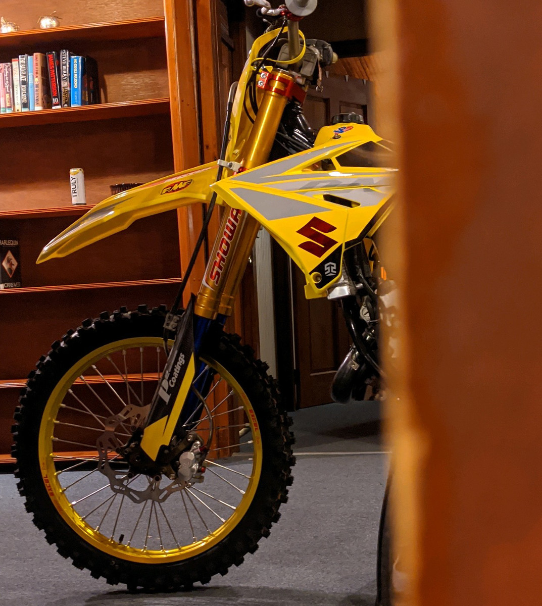

Build Update Pic

[b]Build Update Pic[/b] [img]https://p.vitalmx.com/photos/forums/2020/08/05/442202/s1200_STS_Build_Update_3.jpg[/img]
Build Update Pic
Did those clamps take the 2020 plastics or did you use the restyle kit bracket? I love your build can’t wait to see it.

There is a little bit of a gap between the front number plate and front fender. The restyle bracket caught on the front machining of the triple clamp. I'd hate to start hacking away at the clamp so I'm going to have a professional hacker trim it.
We are working with Vital on some advertising for the bike. I appreciate the community Vital has on their forum and as a business, if I am going to be using their platform, it is the appropriate to support the forum! So with that being said I'll have a few more teaser pics on Monday for sureeee
