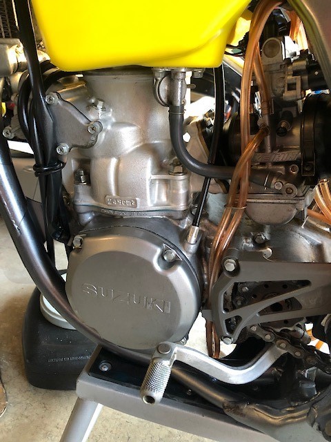

I let the bike soak in WD 40 for a day. I have always had good luck with this. I use WD to penetrate the stuck on dirt, and then I soak the bike in a mild degreaser before pressure washing. It really seems to do the trick in lifting away most of the stain. Ater a quick bath, here's how she sits. Man, the more I dig into this bike, the fresher I think it is.

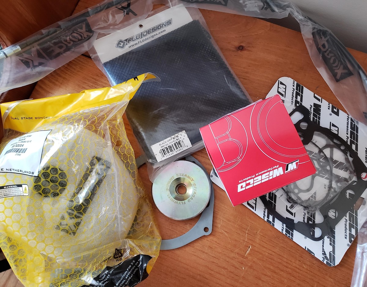

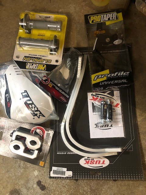

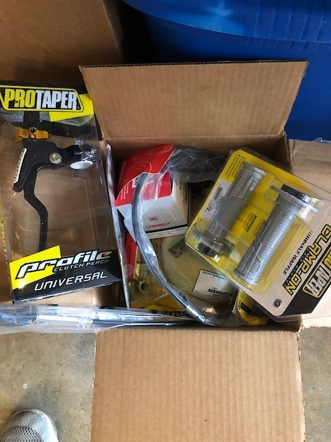

I received a bunch of parts today (some not pictured). So far:
New clear/ pink carb vent hoses
10oz flywheel weight
Wiseco pro-lite piston and gasket kit
Hour meter
Pro Taper lock-on grips (two sets)
Pro Taper Perch and lever (with another replacement lever)
Black Brake lever
Pro-x Air filter
Pro-x clutch cable
Pro Taper bar pad
FLU All black gripper seat cover (trying to look as stock as possible)
Tusk Bark Busters
I can't stand a sloppy/ hard clutch pull. The pro taper perch feels great, at a fraction of the cost of WC. I figure that replacing a 15 year old cable cant hurt either. I got the spare brake lever, clutch lever, and extra grips because this year I want to dabble in some off road racing. Ill be able to spend 20 minutes and take off the back busters, cut levers, cut grips, and switch to my moto stuff before you see me on a MX track with that stuff on my bike.

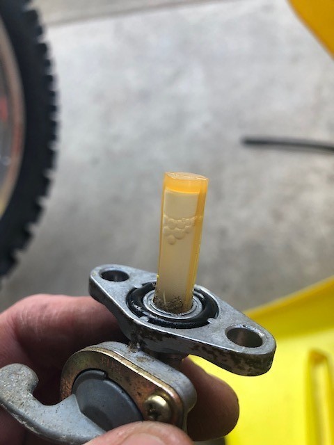

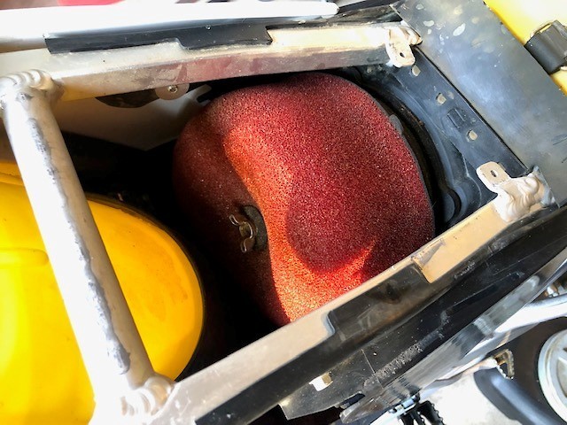

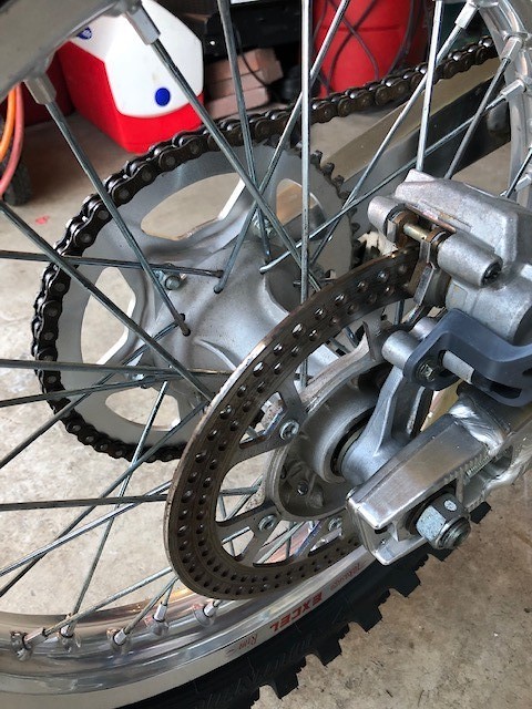

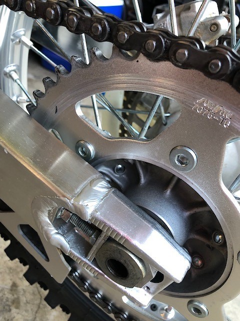

To my delight, the air filter looked fresh as can be. Petcock screen had a bit of trash on it, but nothing too crazy. The gas that was poured out of the tank was old though, just really showing how little this bike was rode. I got the fluids drained, and will be replacing the top end, inspecting crank, and installing hour meter tomorrow. It's driving me nuts how flawless this bike is, but the sprocket has the outside wear from something being messed up in the guide. I'll figure that out before riding it.

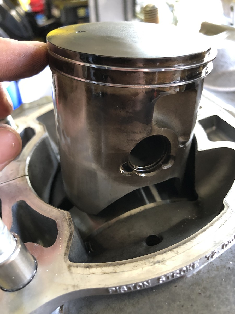

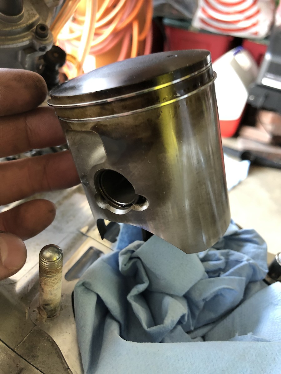

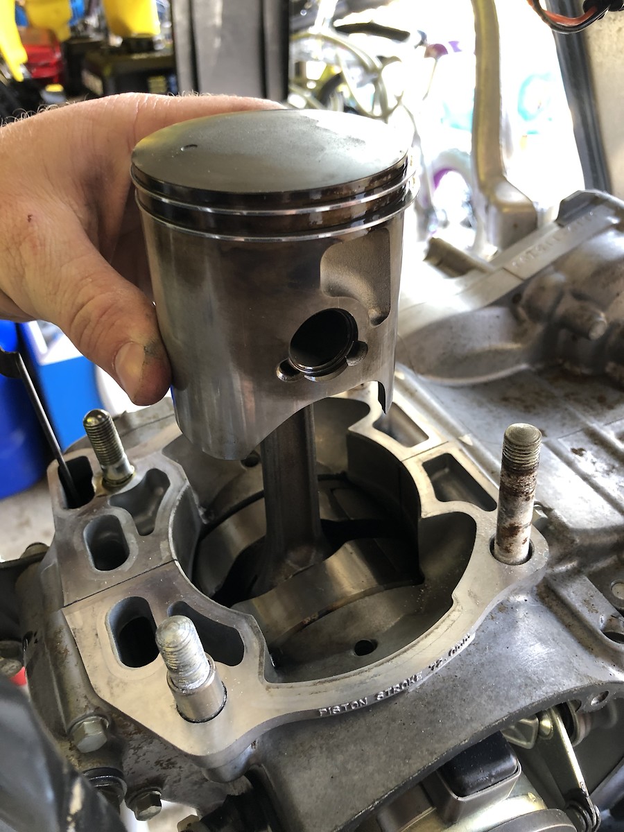

Dug into the bike a bit more today. It was a bit hard to start and had low compression when I bought it, but I took the gamble. The rings were stuck, as shown by the blowby. Cylinder is still in perfect shape with minimal vertical marks none of which are significant at all. This winter when I get the cylinder and head done, I’ll peobably just have them chrome it anyway while it’s there but for now it’s plenty good.
