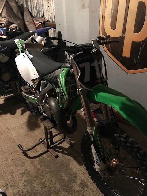

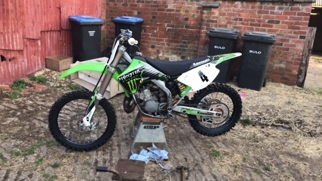

I bought this little beauty a few months ago, and ive been riding it a little always with the idea of making it something special when i can. I forgot how much old bikes can fall apart, especially when they have been stood for years.
It was a field bike, and had been put away dirty so has some parts that need some love. I replaced the fuel pipe, cleaned the carb, put my bars and risers on, threw a piston in and it was pretty sweet. Tried a v force which was real good, and JD sent me an ignition to try which was even better. Toyed between a resto but i love those builds that Primo is building over at PC with the 18 plastics so that is the plan.

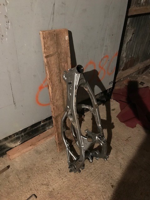

The frame also came back from powder, and the clamps/forks came back from the coaters. I felt like I had to put them together just to make it look like I’d done something haha

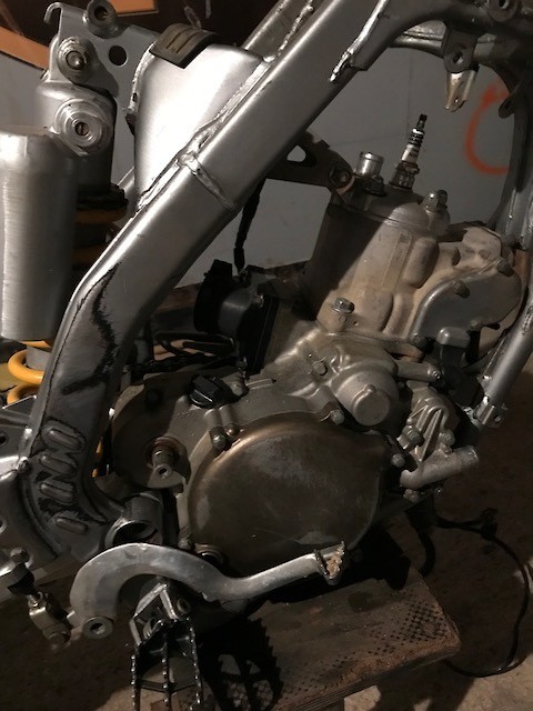

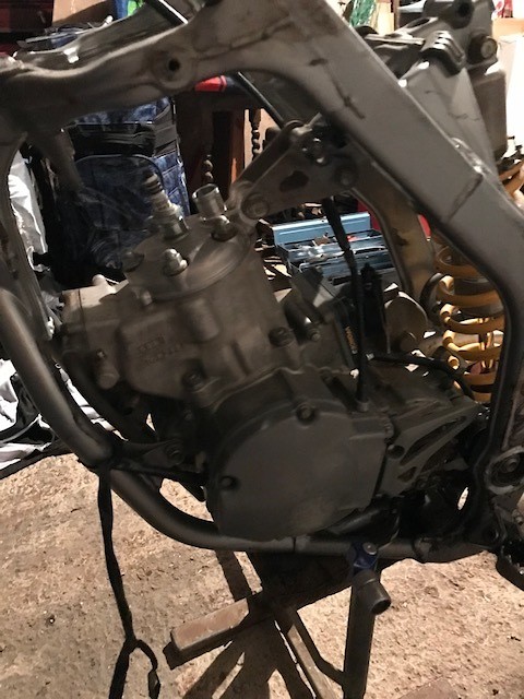

Gearbox due back any day now, and currently working on the hybrid bearings. Once I have all the parts I’ll start with the rebuild
I have ended up going with a company over here in the UK called HB Bearings, and if they dont offer the size ready made they can re manufacture some to replace the ball bearings with ceramics.
Im still waiting on them so ill put some details up when i have them.
The only bearings i could find were main bearings and they were $110 each!
Heres a list of all bearing sizes in the bottom end

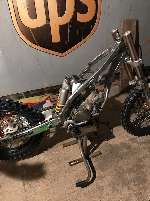

Everything has been dry fit to see how it fits, next is the disassemble and rebuild with everything as it should be.
There have been some challenges, foot pegs in particular!
