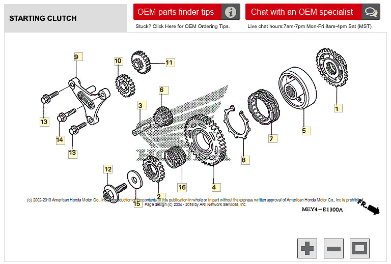

Does the engine even turn over at all with the e start button? If the electric starter engages but you don't hear the engine turning over, just the electric starter motor and some gears, gear number 6 in the microfiche may have broken and now the little gear may be allowed to spin independently. The easiest way to check this is to pull your right crankcase cover off and hit the e-start button to see if this happens. The little gear is pressed onto the larger one and the two should spin as one, if they are working as intended. If the little gear spins, but the larger one does not, then the starter reduction gear is broken and needs to be replaced.

Yes I should have clarified. It turns over with the e-start button. It does not drag or turn slow.
