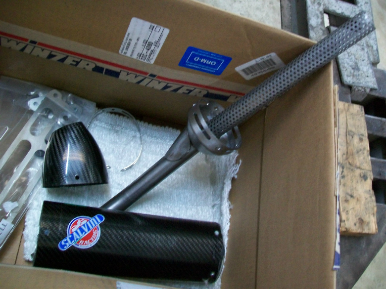

Has anyone cut down a FMF spark arrestor for a YZ125? I want it to be a little shorter then what it is but was wondering how to go about it with the powercore that FMF uses.
Any suggestions would be great.
Thanks

How do the internals differ from a regular silencer? Or is it just a spark arresting insert at the endcap?
I have cut down several silencers before. However much comes off the outer, take that much off the perforated core. Some where more difficult than others but none too hard. Just dive in, don't be afraid!
