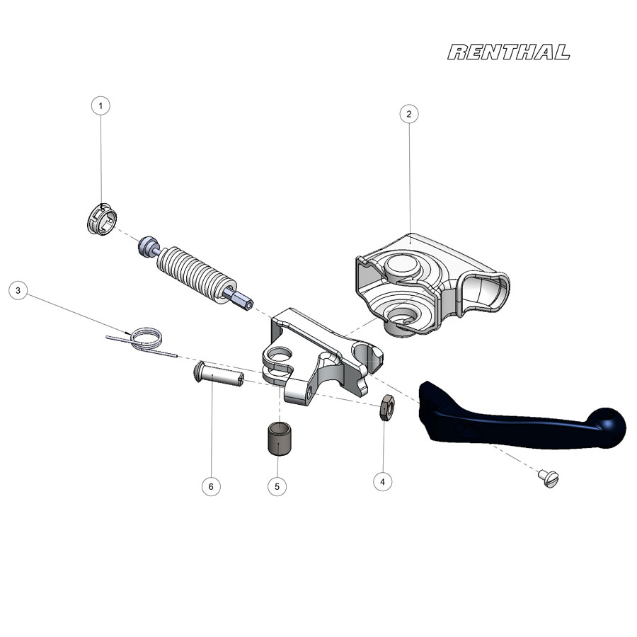

I am building my yz125 06 and can get a good deal on some sweet parts.
Such as renthal intellilever but there for the newer style yamaha front brake 08 and up. Will these levers fitt my 06 with some modification.

2006 on top, 2008+ on bottom. Look at the part on the lower right that pushes the m/c plunger. Quite a bit different.

Yea they won’t work, I have a silver Arc brake lever for your 06 I’ll sell you for $20 if you’re interested.

I have found a set of intellilever for the newer brakes and it looks like you can screw in the older style part.
old
new
https://i.ebayimg.com/00/s/NTQ1WDcyNg==/z/4D4AAOSwGFVeeRHi/$_86.JPG
