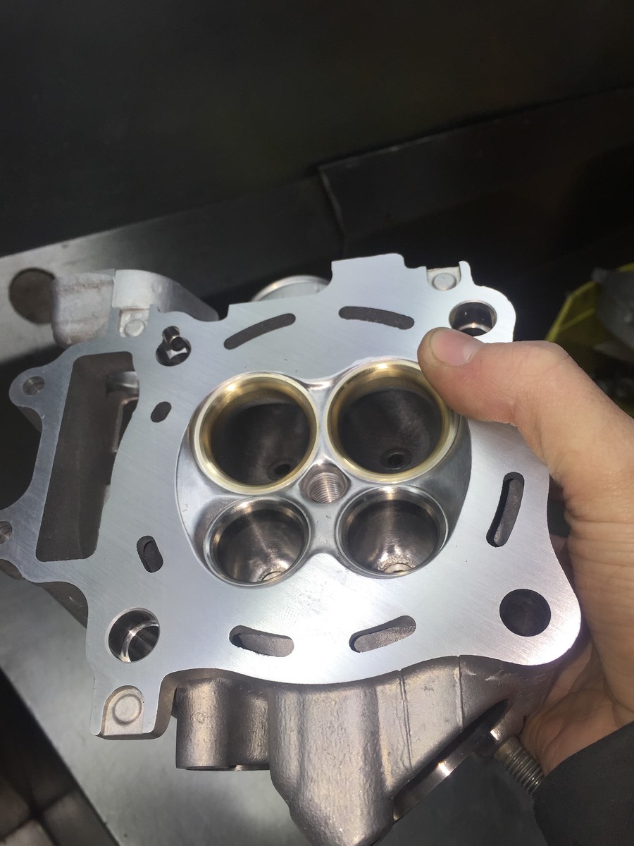

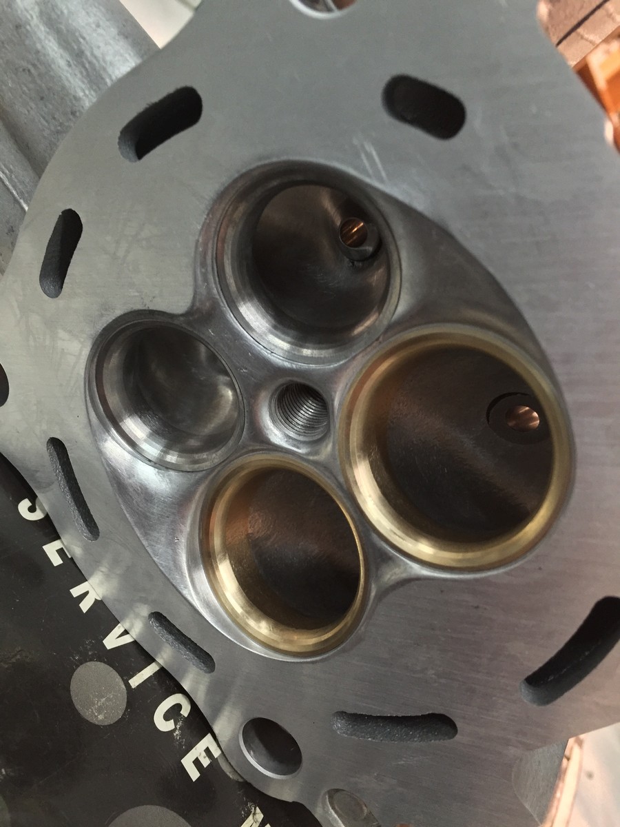

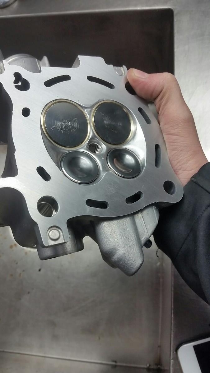

8/18/2017 11:14 AM
Mow that is a pretty head and ready for action.
Paw Paw
8/18/2017 11:18 AM
Good power, builder series hot cam. Heavy duty springs, upgraded DLC buckets, vortex ecu, ported tb, moto Tass
