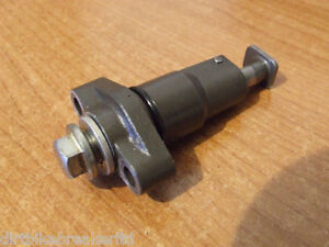

The only thing I noticed is that the timing chain feels a lot more tensioned now I have put it back together compared to how it was when I first opened it up, is it possible I messed something up? I believe the tensioner is an automatic one, pic below of how it looks.

Those cam chains when they are in place with the adjuster in are usually pretty tight so I wouldn't worry about that too much. When you reinstalled it did you back it all the way off and then let it re-adjust itself once in place?

That is a ratchet type cam chain tensioner. You have to release it and move the arm back into the body. You install the CCT then put the spring/rod in it. Otherwise it will be over tensioned. If you just bolted it back in the cam chain is at full tension and WILL break.

Cheers for the replies guys. I re-did the tensioner and it still sounds like in the video, not exactly sure what to do next.
