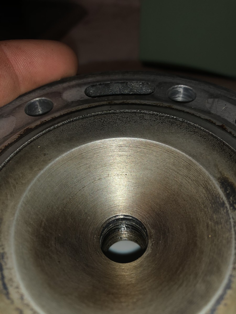

Pulled my head off because the owner before raised the compression which has cause me to buy a lot of race gas and I’m tired of buying it and so I am planning to get my squish set for pump gas. There are some pitting marks alongside the intake side of my head. I have added a pic of my spark plug and my piston head (37 hours) for help of diagnosis. I also added a picture of the cylinder head that is not pitted.

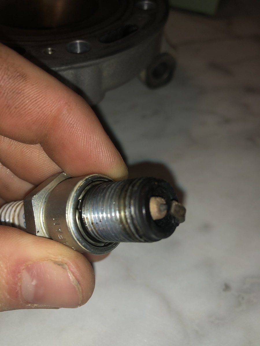

Based on the color of your plug and the almost total coverage of carbon on the piston crown (in addition to the pitting from pinging) I'd say your jetting is on the lean side. My YZ250 is as crisp as you like and it has less carbon coverage than that, i.e. more piston wash from being richer.
Can you tell us your jetting, fuel, oil and ratio ?

piston crown shows it’s lean... Yz250s are known to detonate... As mentioned above you may be too lean on your fuel mixture, your jetting, or a combination of both...But normally the best ways to cure this problem is to have the squish corrected for pump gas or retard the timing a degree or two from stock spec...

180 main, 48 pilot, 3rd clip position. I’ve thought about going to 2nd clip position. 100LL aviation fuel, yamalube 32/1. And I will be having my squish set for pump gas. I’m taking my head tomorrow.

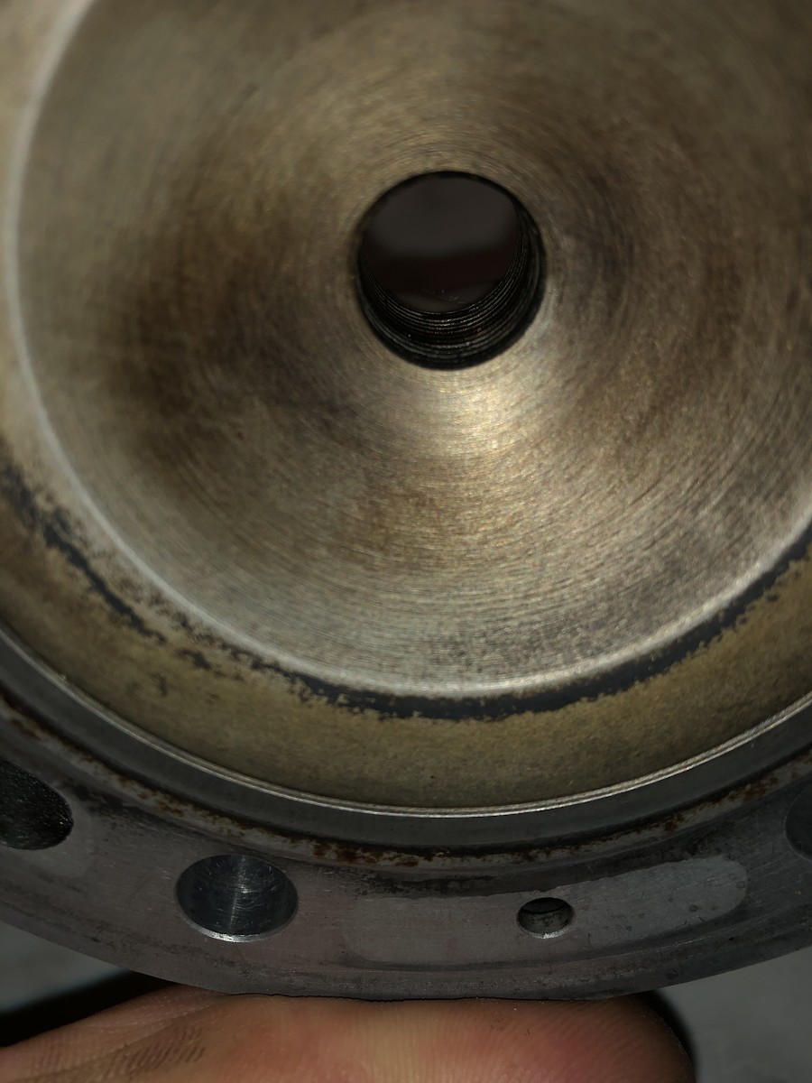

looks a hair lean..the outer edges of the squish band show signs of detonation..the wash looks OK.
I would have advised you to do a compression test before you pulled the head to see where your PSI is as well as a squish test to see how much space you are dealing with and advise you to remove material from the bowl as opposed to recessing the squish to get your octane with in spec for your needs..sometimes the squish is fine but the head needs less material in it to lower the comp ratio.
The main determining factor for detonation is oct vs comp ratio, squish plays a part in it, but your overall comp ratio is more responsible for deto than your squish clearance bc when your engine is under "load" this is where you can get into trouble fast...the YZ250 has (2) compression ratio's and depending on where you ride it in the powerband can determine how you should be dealing with the engine..trail ride vs mx so to speak.
A trapped volume test would have been able to tell you how many cc's you have when you piston is a tdc, this is the factor to use to determine how many cc's you want to change either way to get either lower or higher comp ratio.
I pushed the YZ250 to above 250 psi on VPC12 at about 1.2mm of squish and it ran great but many back and forth trips from the bench to the lathe to get the cc's right.
So the PO cut the head, you want to run pump, I say have the tuner lower the comp ratio of the head by removing material fro the bowl to get it right, leave the squish clearance alone. If this gets to difficult bc you need to know what you are at now vs what you want to be at, buy a new head, run pump gas, go ride. Just simply cutting into the squish band will make it worse.
