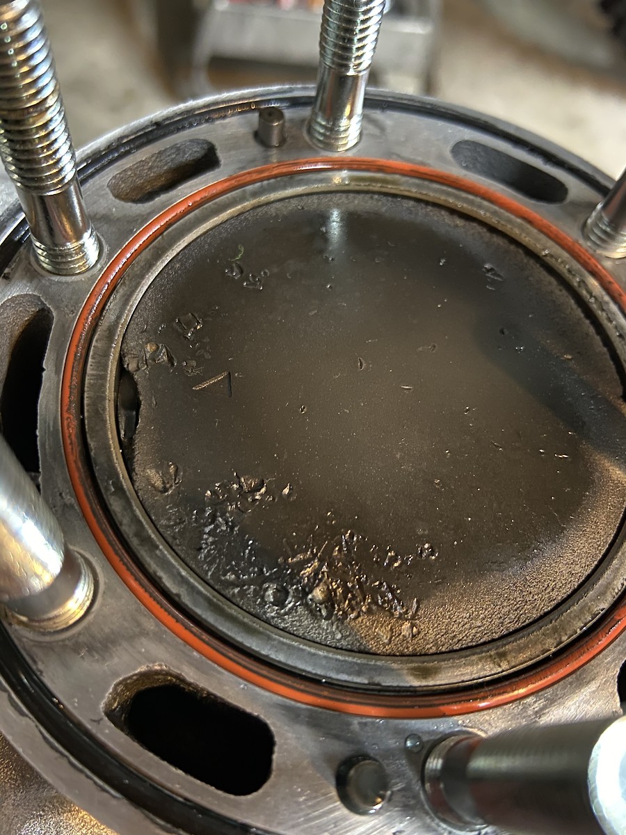

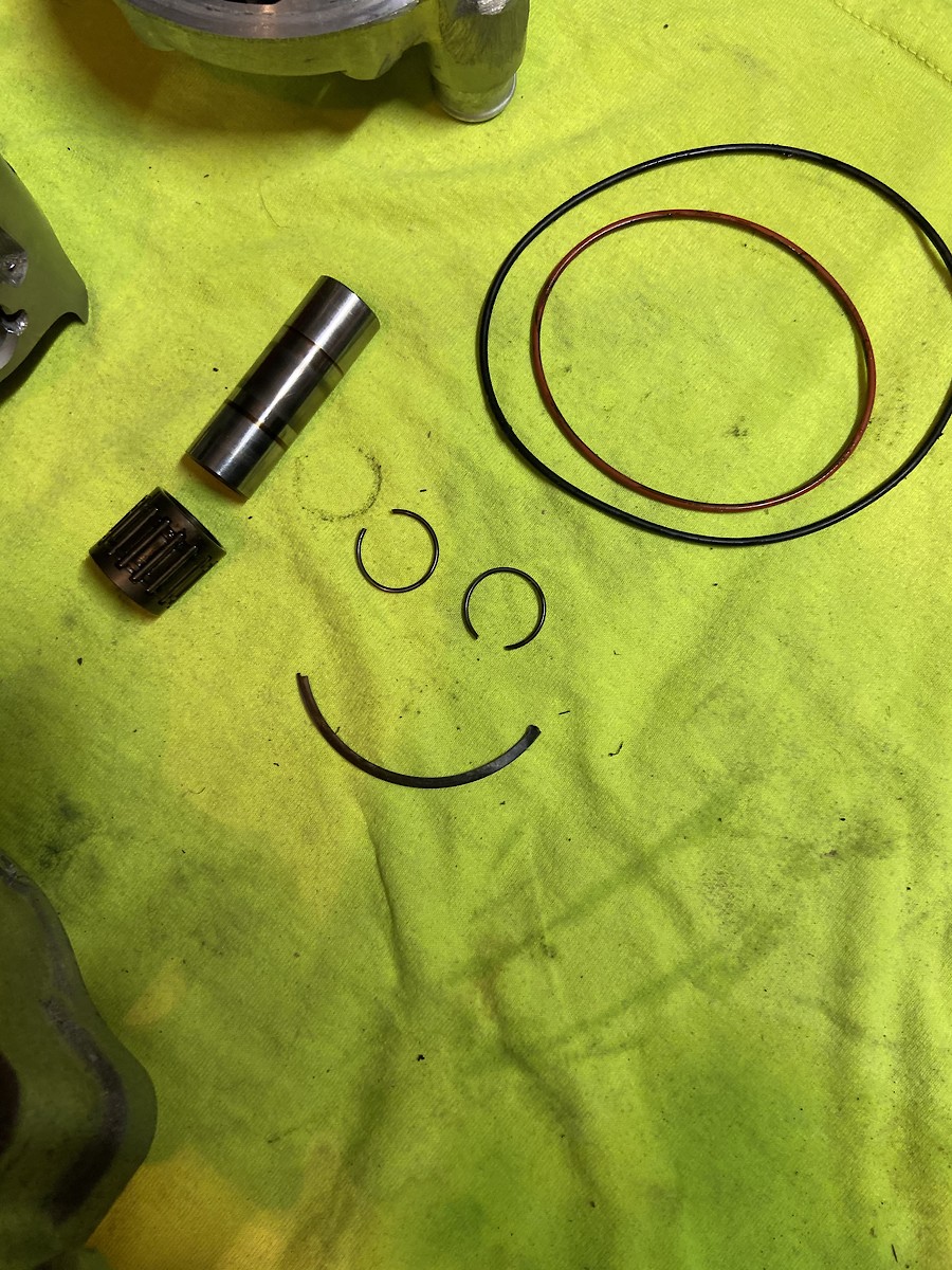

2019, less than 2 hours on the entire bike. Was running 30:1 like the manual calls for. Had to have been bad pump gas, right?

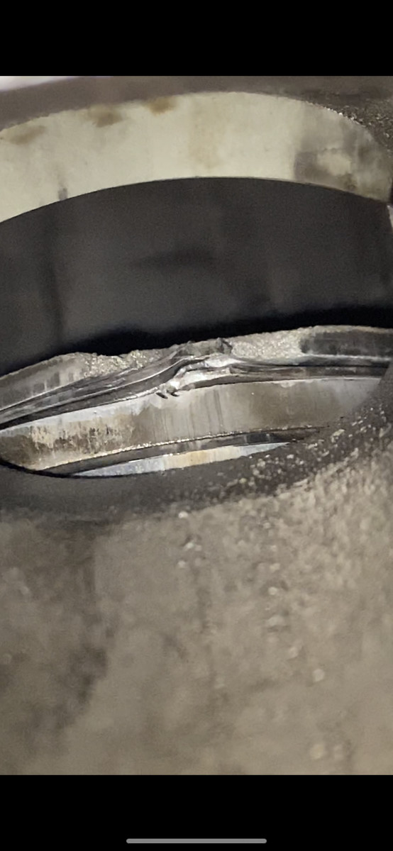

Looks like it snagged a ring on the power valve. The power valve must have been extended excessively into the bore. Might be something wrong with the power valve mechanism up top that allowed that to happen.

X2 but I also see what looks like it has a squish issue. If so the excess heat created cause the ring to become loose in a distorted piston ring land and thus distort and cause the failure.

The etching on the piston and head are signs of detonation. Once that starts temps will escalate quickly and it will begin to burn off the exhaust side of the piston crown. Molten aluminum starts to build up in the exhaust port, the ring becomes over heated, soften, looses support from the burnt off crown and hangs up on the exhaust port or the build up of aluminum in the port from the piston.
Detonation comes down to the lack of necessary fuel or octane for the combustion conditions. IE, the amount for compression, spark advance, squish clearance, lean jetting and so on. Low octane pump gas with a lot of ethanol that has set more than a couple of weeks is a very good catalyst for something like this.
Since this appears to be a totally stock, new engine, I would chalk this up to bad fuel or possibly clogged jets.

Oh and I forgot to mention that the plug didn’t look lean so it had to have been bad gas. Looks like I’ll need to locate some higher octane fuel near me.
2/27/2021 9:55am
The plug won't be a good indicator in a failure like this. It was probably dark like the top of the piston and that's basically aluminum and oil mixing together. If the engine is able to stay spinning very long after the compression drops way off, things will start to cool down about as fast as they heated up and your plug won't tell the tale of what really happened.
