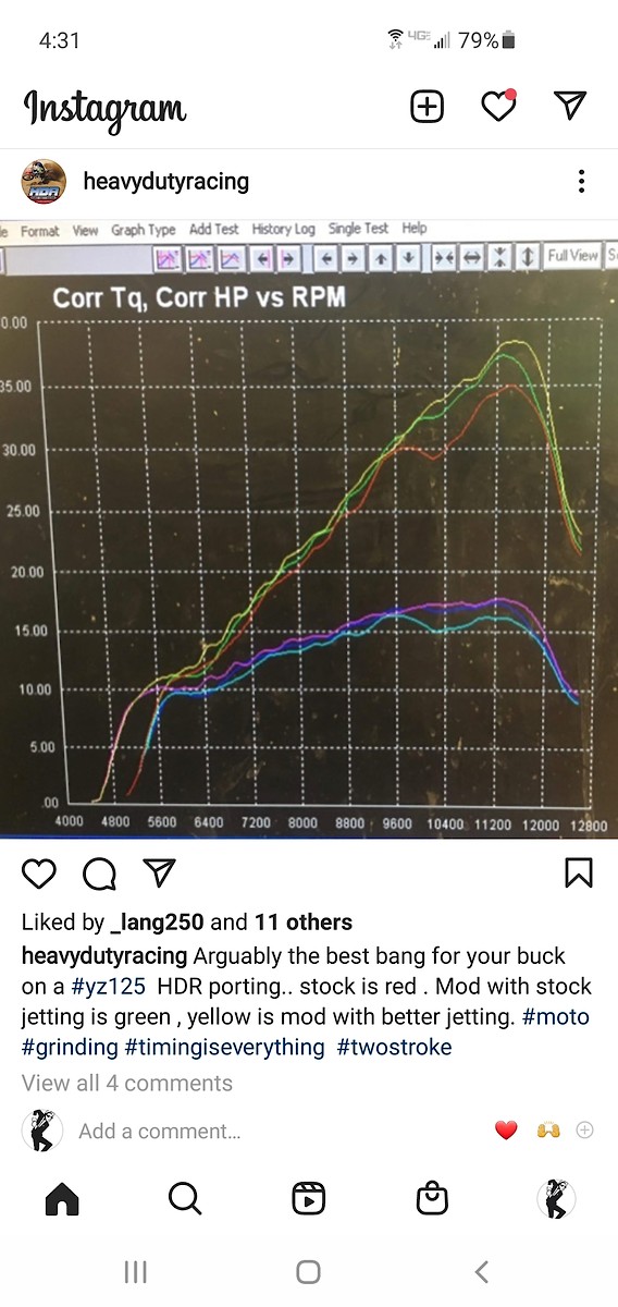

Bruce372
6341
3/31/2021 4:28pm
Bruce372 wrote:
Heavy duty racing on the east coast.
Pete did my 150, it was a ripper.
Pete has spent a lot of dyno time on the yz125.
