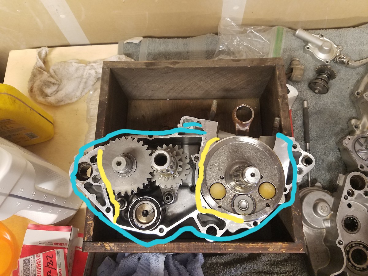

When joining cases do you put the gasket maker along all the mating surface or just the outer edge?
10/22/2018 1:55 PM
So basically along both lines or just along the blue line?
10/22/2018 2:33 PM
Edited Date/Time: 10/22/2018 2:33 PM
Follow both lines the crankcase has to be completely sealed from the transmission on a 2 stroke... you can find a manual it will show you the preferred way to lay the case bond... Also the top of the rod looks a little rusty?
10/22/2018 3:02 PM
Completely very thin coat on both halves
10/22/2018 3:15 PM
Applied at thin layer of sealant along all the mating surfaces of both halves. Photo
10/22/2018 3:34 PM
That is the proper way.
